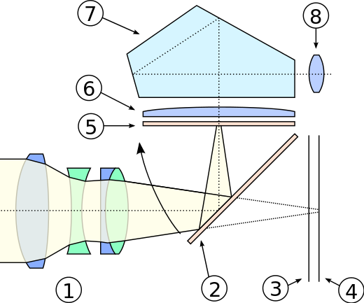

Correct!  You cannot shoot video through the viewfinder.  The camera raises the mirror to expose the sensor, which cuts off the reflected image to the viewfinder.
Here is a crude diagram of how it works in most DSLR cameras.  What is not shown is the AF sensor, which would be directly below the mirror.  The AF sensor would sit between the #2 and #3, approximately.  The metering sensor is at the top of the viewfinder, which is not really shown either.
