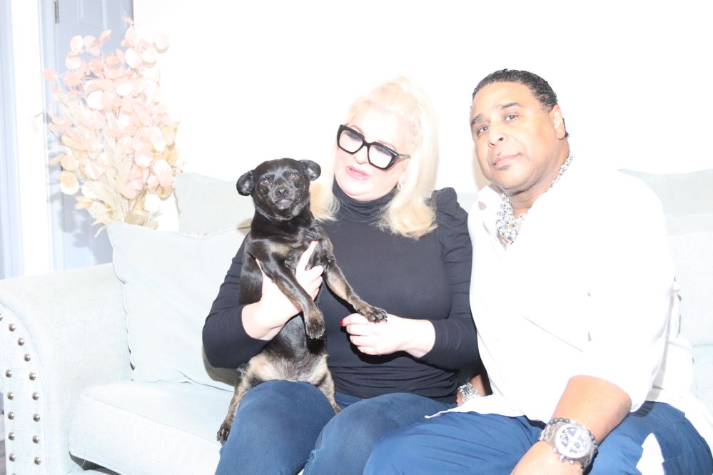

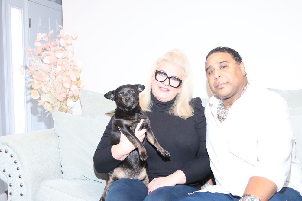

Yes I live with that Tamaron lens for a couple of years. I did try a Canon lens yesterday with the Godox flash - with the flash bracket, shoe cord and the new camera Canon T8iIMG_1697.JPGIMG_1698.JPG
I do not change the settings and yes it was the same lens - so that is the only thing I did not change - but I did yesterday - and got the examples I just postedIMG_1697.JPGIMG_1698.JPG
Did you use flash for the 2nd picture it definitely looks like its overexposed. The EXIF Data shows no flash was used. Canon lenses and some 3rd party lenses have a distance encoder for flash exposure. The distance info for flash exposure only works for direct flash not with bounce flash.

What’s interesting to me is that while the subjects are slightly overexposed the more distant area, like the door, seems even more overexposed. Was this on camera or off camera flash?
