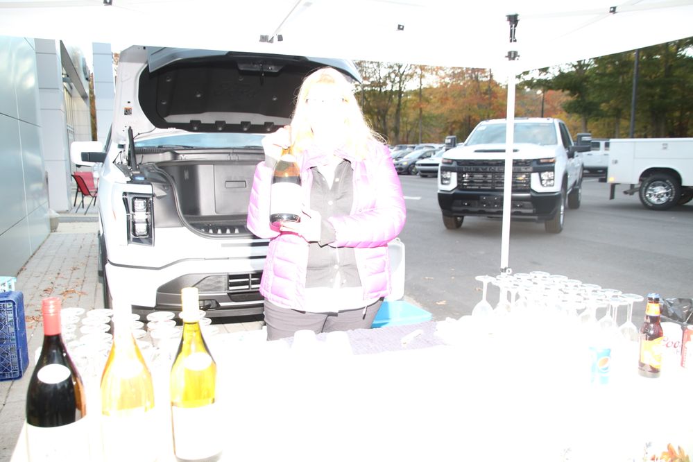

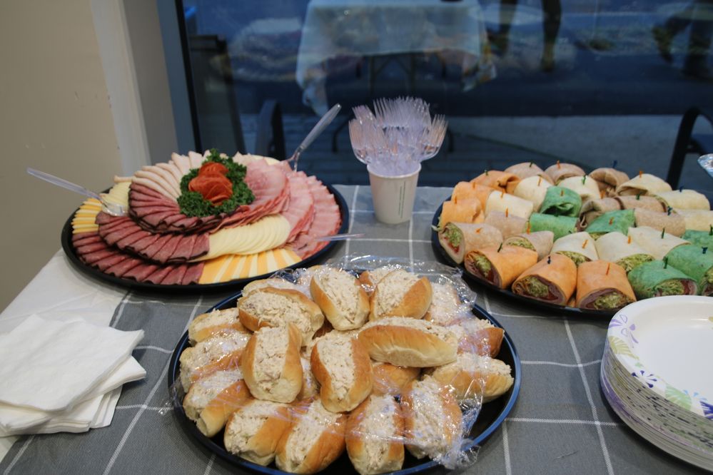

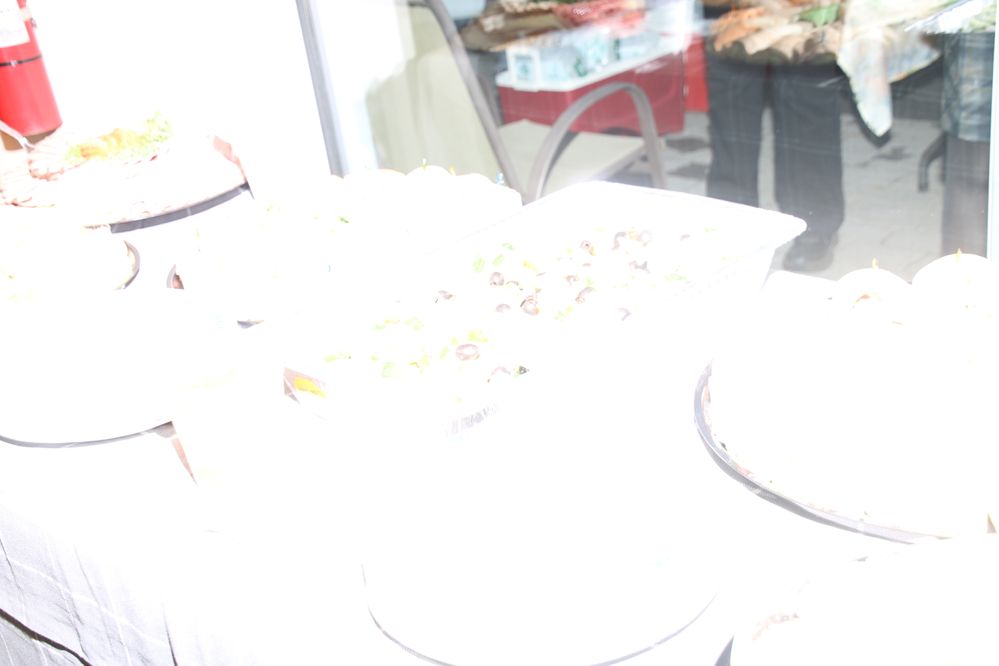

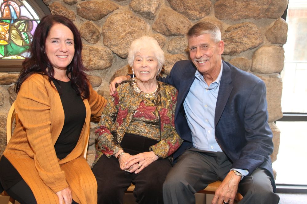

AnnieO
examplesIMG_1703.JPGIMG_1704.JPGIMG_1707.JPGIMG_1708.JPGIMG_1709.JPGIMG_0665.JPGIMG_0667.JPGIMG_0674.JPGIMG_0676.JPGIMG_0698.JPGIMG_0699.JPGIMG_0903.JPGIMG_0904.JPGIMG_0937.JPGIMG_0938.JPG
Sorry AnnieO there isn't any EXIF data with these pictures. If you can find the EXIF data please post a screen shot of it separately. What is your Canon speedlite set to when this occurs. Is it set to E-TTL or TTL. The overexposed pictures look like the speedlite was set to TTL instead of E-TTL which causes overexposure. A speedlite set to TTL will always cause gross overexposure.

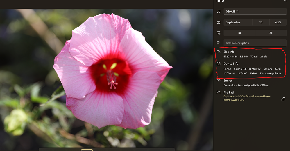

Thank you I tried to show pics from the same events so you can see how some are ok and others are not. I believe they were all ETTL I have no idea what is EXIF -
EXIF Data is data info about a given picture. Cameras usually use EXIF Data to show exposure settings, camera manufacturer, Lens make, lens focal length and other info about a given picture.
The area in the red square is the info that is neededThe area in the red square is the info that is needed

Actually some of your pictures do have EXIF Data attached but all of the pictures that are overexposed lack EXIF Data. Your other pictures report that you were using a Tamron lens. Did you switch out lenses during the shots.
