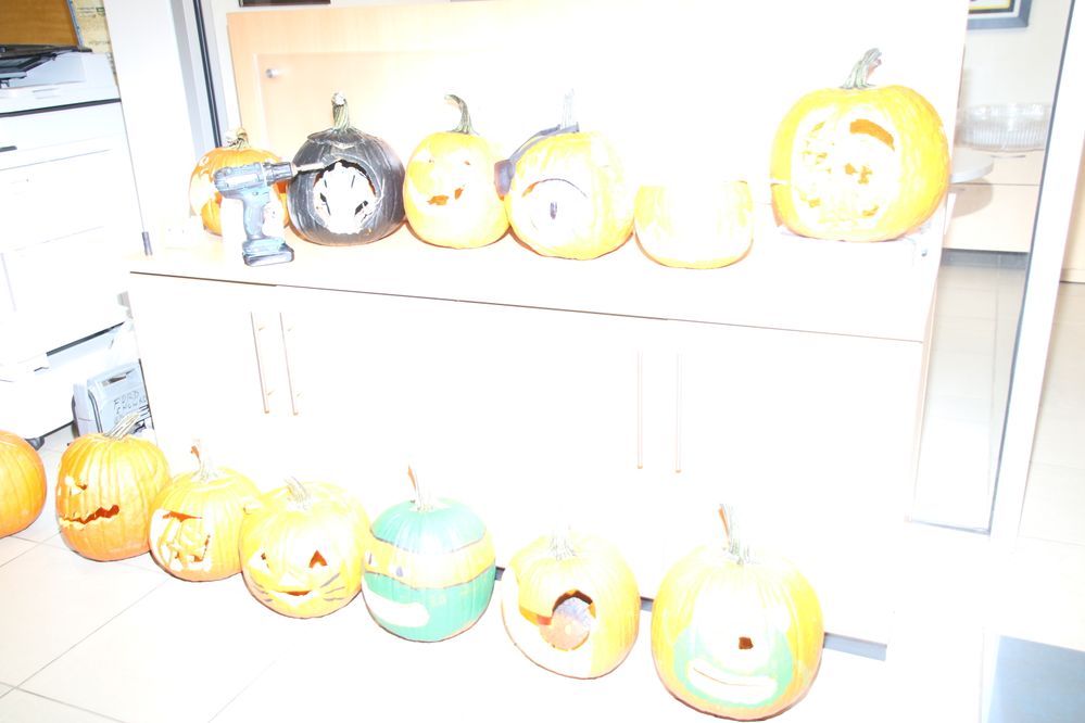

I have a Canon T6i - use Auto mode- with flash bracket, shoe cord and a canon Speedlite. All is fine then in September it started to overexpose the photo - not every one but many at the event. then I read on a forum that it happens with Canon Speedlites - I then got a Neewer flash, and two Godox flashes - same issues. All in TTL setting. I then got the Canon T8i - and same issues. Then I tried new shoe cords - same issue. Tried not using the flash bracket - same issue - then I tried the new camera and a different lens - same issue. I am at the end of my experiments and cannot figure the issues. Please help - I have many events coming up and need this to work. I have asked so many people and no one can seem to help. I changed batteries, I used the rechargable battery for one of the Godox. All the same issues HELP

I have many sample pics to show you. How do I do that?

examples
11-23-2022 12:18 PM
Sorry AnnieO there isn't any EXIF data with these pictures. If you can find the EXIF data please post a screen shot of it separately. What is your Canon speedlite set to when this occurs. Is it set to E-TTL or TTL. The overexposed pictures look like the speedlite was set to TTL instead of E-TTL which causes overexposure. A speedlite set to TTL will always cause gross overexposure.

Thank you I tried to show pics from the same events so you can see how some are ok and others are not. I believe they were all ETTL I have no idea what is EXIF -

Actually some of your pictures do have EXIF Data attached but all of the pictures that are overexposed lack EXIF Data. Your other pictures report that you were using a Tamron lens. Did you switch out lenses during the shots.

Are these all with the same lens? That seems to be the only constant. Switch to AV mode and set f/16. Try to do a few depth of preview tests to see if the lens stops down.
11-23-2022 02:27 PM
The OP is using TAMRON 16-300mm F/3.5-6.3 Di II VC PZD lens in some pictures with the EXIF Data intact. The pictures without the EXIF Data intact are the overexposed shots.
