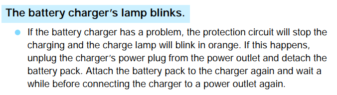

The blinking orange light is a safety measure that prevented any damage to your charger, battery, or property. When you tried in another outlet and it turned green, that means everything is perfectly fine. The following is from page 284 of your manual:

This may not be a problem.
If a battery is *particularly* low, it can trick the charger into thinking it wont take a charge. While I don't have the link handy, one of Canon's trouble-shooting tips was simply to simply re-try a few times until it starts charging.
The idea is that when you first plug in the battery charger, it will begin charging the battery ... then check to see how the battery is doing. In that short initial charge, it will slightly bring up the charge level of a good battery... but when it checks the battery level, it will be down so low as to appear to be a defective battery, so it gives up and starts blinking the light.
When you re-try, it will manage to get another 30 seconds worth of power into the battery. Again, a truely bad battery would read dead. A good battery would have taken on slightly more power ... but might still read too low and trick the charger into giving up and blinking orange.
But usually once you've done this about 3 times... you get just enough power into the battery that it finally makes it above the low voltage threshold and and the battery charger realizes that it is taking a charge.
If you end up having to try more than about 3 times and it still blinks organge... you probably really do have a bad battery and you should replace it and have the old one recycled (never toss batteries in the trash).
This is all avoided if you don't let the batteries sit too long without being used and don't let the batteries go completely flat.
It's not really a defect... it's a safety measure designed to prevent the charger from attempting to force power into a battery that has shorted out.
