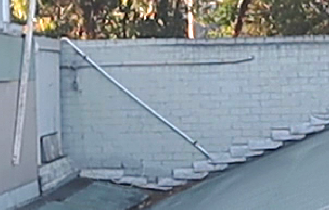

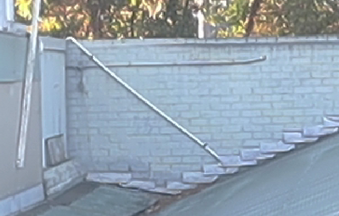

I guess i found the reason for the low quality 1080p.
It is the shutter speed.
Here is the zoomed part of the snapshot from 1080p video filmed at 1/25 shutter speed using 15-45mm kit lens:
Here is the zoomed part of the snapshot from 1080p video filmed at 1/640 shutter speed (as in previous example):
Looks like the shutter speed setting significantly degrades the video quality. It is not seen by the naked eye since you need to zoom the video.
I tested other speeds and it seems all speeds higher than 1/30! lead to the degradation in video quality.
So it seems the optimum is to shoot 1080p at 1/30, not faster.
In this case, the exposition can be controlled using ND filter.
Quality degradation is significant even at 1/100:
05-31-2021 06:41 AM
The last three images you posted all look the same in terms of quality. All are pixelated. The first though looks a tad bit overexposed.
For video, you generally want to use a 180-degree "shutter angle". For cameras, the shutter would be one over double the framerate. So if you're capturing in 30 fps, shutter would be 1/60 second. Of course you can change the shutter for specific looks, but the 180-degree setting will give the most natural motion blur for moving subjects.
Having said that, if you set the shutter to a high value, the aperture will be stopped down and/or ISO (gain) increased. On lenses that are stopped down alot (near their maximum), diffraction can cause image quality to degrade. And higher ISO also causes image quality to degrade.
Thus, it's not the shutter speed that is leading to the lower quality footage.
