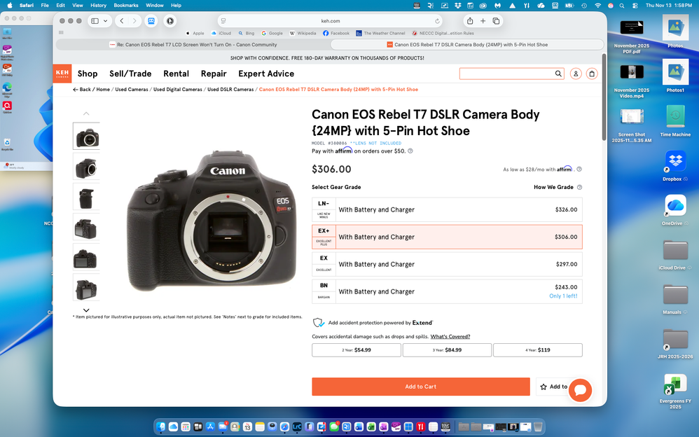

11-13-2025 02:01 PM
@Desiderata2001 wrote:
After all this time and 9 repairs of the T7's I have an answer from Canon. It turns out it is the shutter button being used too much and breaking, they recommend that I use prosumer models instead (wish I could afford that).
One of these plus an extended warranty might meet your needs.
Thses are five pin hotshot models that will lett you use third party flash units.
