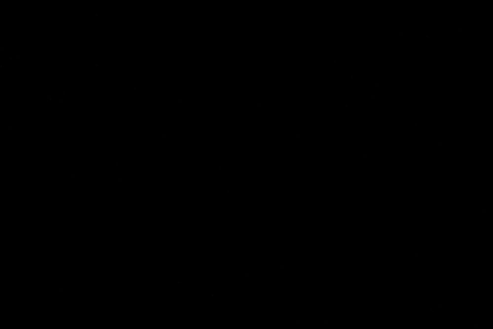

I have bought a Canon R6 MKII about 6 months ago.
And i notice some red dots on a pictures with some long exposure 5s to 10s and iso around 400/800.
I have done sensor cleaning and manual cleaning to see if they go away, but they only reduce the brightness and size, and now i see white and red dots, small but a lot.
Can some one give me some opinion ?
Thank You/ Kind Regard's
Vitor

As you mentioned that the upload, could change the images, here is a link to the same, you need to view it a 100%, and the spots are localized on top left side.

Thank you Peter, i have upload one more couples of images, you can check them now.
10-29-2023 12:36 PM
Nothing unusual in your other samples.

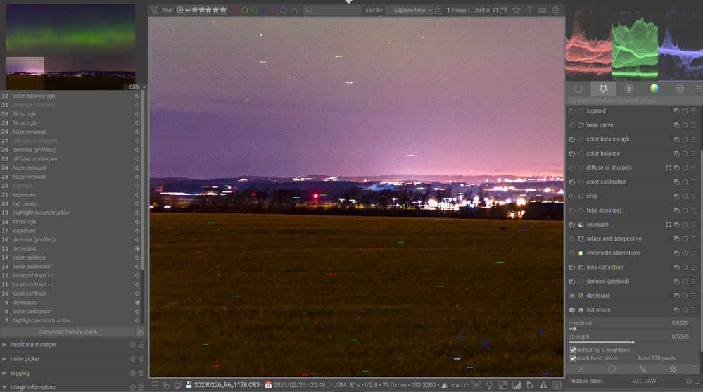

I don't have any issues at shutter speeds faster than 1 second. At longer shutter speeds I just use Long exposure noise reduction. It doesn't just remove hot pixels but also amp glow. Take a look at this thread https://community.usa.canon.com/t5/EOS-DSLR-Mirrorless-Cameras/EOS-R3-Green-cast-in-edges-of-the-fra...
And this is from my R6 at ISO 3200 and 8 seconds. I didn't have Long exposure noise reduction turned on. Some false positives from the lights, but take a look at the ground.
The next day. Long exposure noise reduction turned on. darktable only found three hot pixels in the whole image. I can't find them. ISO 3200 and 4 seconds.
