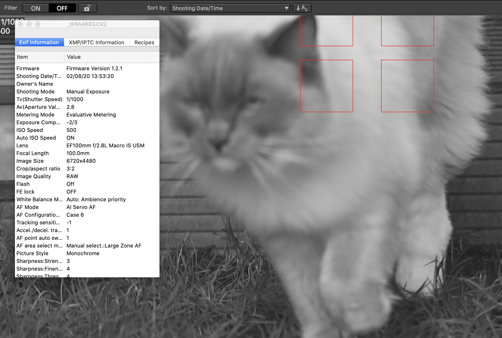

I'm trying to take photos of my cats (action/movement shots) but I'm not really getting any shots in focus. Before I declare that "I just need to practice more" I want to make sure I'm using the right settings  (AF system is so complicated and new to action shots as well). Based on these next photos my hypothesis is I have one or more of these issues concurrently:

Here are a few examples with AF points on:

I have never tried to use my macro lens for action photography.  I do not know if it could focus fast enough to keep up with the frame rate.  For that reason, I would change 2nd Image Priority to FOCUS.
Turn off IS in the macro lens, too.  Doing so may make the view through viewfinder a little more jumpy, but it will train you to steady your hand.  I would use at least 1/1600 shutter speed.  Do not be afraid to let the Auto ISO rise to ISO 3200.  The camera can easily handle it.
I would manually select the initial AF point as being the center AF point.  You want to tell the camera where to focus.  Disabling iTR focus tracking may help, too.  But, hold off on doing that just yet.
Yes, you do need to practice shooting.  Using the center AF point as a starting point will improve how well YOU can track the subjects, keeping them centered within the viewfinder frame.  For this reason, I am going to suggest that you enable all of the AF points.  If your active AF points slip off the subject, the camera should lock focus on the nearest subject to the camera, which in the sample photos will most likely be the cat.

I really don't think of the 100MM macro as an action lens where it is having to rapidly focus on a subject moving to or away from the lens.  It isn't dreadfully slow but I would never try to shoot sports or a cat who isn't asleep using that lens.  Maybe the latest version is better, my 100MM Canon macro is a few years old.  It is a marvelously sharp lens.
DoF is dependent upon distance and focal length and you may find that your 50MM, perhaps stepped down some from wide open aperture, is the better choice.  When you are trying to photograph a cat (and that is a beautiful Siamese!) if you have a shallow DoF setup, then you need to keep the focus point on his/her face and accept that down the body it will not be in sharp focus when you are shooting lengthwise towards your pets.  It is not unlike shooting a football player laid out horizontally to make a catch when he is facing towards the camera, often conditions and your camera setup mean that only part of the player is going to be within critical focus.
For the cat action photos, consider for some shots using the resolution ability of the 5DIV and cropping and don't try to fill 90-100 percent of the frame with the subject.  This will generally let you frame your subject so that DoF is going to be deeper instead of being so close to the cat.
I shoot a lot of fast sports and I use AI servo but with a single AF point that I keep where I want it.  You may find that provides the best keeper rate with your cats.
Your framing of the cat's motion also determines how fast of a shutter speed you need to perfectly freeze motion.  If it is cutting across the frame, a faster shutter speed is need versus if it is moving towards or away from your position so when light is less favorable try framing it so that the majority of motion is inline and not parallel to your position.  With sports you can often pan to reduce this form of motion blur but I have owned a LOT of cats and none of them have been as predictable even compared to high strung athletes so panning to avoid motion blur is difficult and often a matter of luck  🙂
