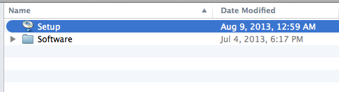

When I upgraded to Mavericks, I noticed EOS Utility stopped working for remote shooting. I tried downloading the Mavericks update but it still wouldn't work.
I tried deleting & reinstalling EOS Digital Solition Disk. Insert the CD, I can't start the installation process. Clicking the startup icon does nothing.

jrhoffman75
Try downloading software from here:
http://www.usa.canon.com/cusa/support/consumer/eos_slr_camera_systems/eos_digital_slr_cameras/eos_1d...
John Hoffman
Conway, NH
Mykolas
Hi supremeconvoy!
Thanks for posting.
Depending on what camera you have, full versions of the software package can be downloaded from our website.  Please click HERE to go there.  Enter the model camera you have, then select the EOS Digital Solution Disk Software 28.2A from the list.  Once installed, you can update using the other downloads on that same page.
