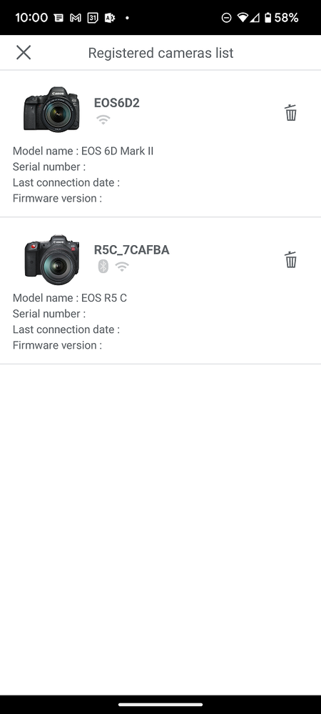

As mentioned previously, you may want to start over, resetting the Camera's network settings, and remove the saved profile for the camera in the App.
Remove Camera Profile
Tap hamburger menu top right
