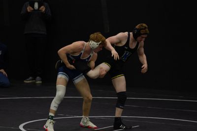

These are both unedited.
ISO 1600 f2.8 1/500s 200mm
ISO 1600. F2.8. 1/500s. 75 mm

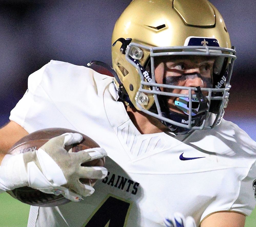

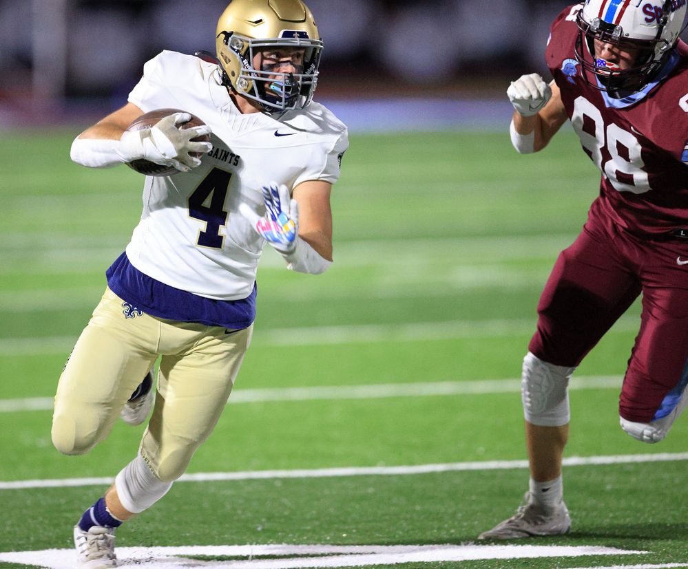

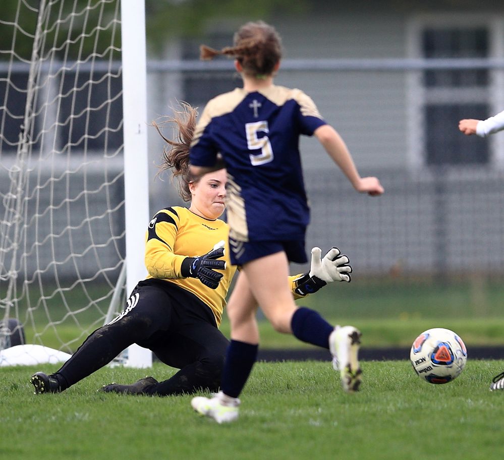

You are welcome! Mat side placement will make a huge difference when low light forces the use of a higher ISO setting.
As an example, here are two crops of the same frame shot with a Canon 1DX III which is very well behaved at high ISO and this was captured at ISO 10,000. The first jpg is from 80% of the sensor area while the second is from just over 8% and at this high ISO it makes the grain coupled with loss of detail very noticeable with a heavy crop.
The third image is using the same 1DX III body and EF 400 f2.8 glass but at ISO 250 where this crop using only 7% of the sensor area still provides a decently clean and detailed image. With excellent lighting allowing a low ISO choice, you can crop severely but once the ISO goes up then so does noise and heavy cropping results in a mixture of undesired noise and loss of detail.
Rodger
