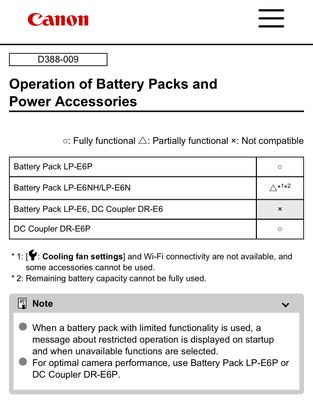

Presumably you’re using the battery that came with the camera when you bought it? Have you checked to ensure it’s the correct one (LP-E6P) for your camera as not all are fully compatible. The chart below is from your camera’s owners manual:
You can also try charging the battery whilst in the camera via a DC coupler (USB cable and charger) DR-E6P, which I believe is sold separately. Otherwise do as others have suggested and contact the store where you purchased it and / or Canon for warranty service.
