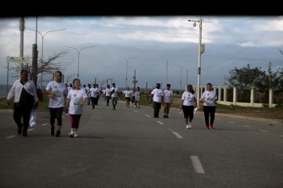

Am seeing the black line at the top of the screen almost like a tick edge line compared to the other sides. It shows on live view and on the photos after the shot. Please I need help as to how do I get this black line off. Is it something to do with the shutter or.

Here is the image taken

This is on every photo? You are sure you don't have something in front of the camera/lens? It really doesn't look like a shutter blade but I suspect it probably is. It will have to go to Canon for service. Call 1 (800) 652-2666 to make sure the Mk III is still serviceable.

Yes, that's on every photo. Even when I change lense, it's still the same.
10-19-2023 04:01 PM - edited 10-19-2023 04:02 PM
Shutter blade or mirror, but I guess shutter blade due to the angle.
