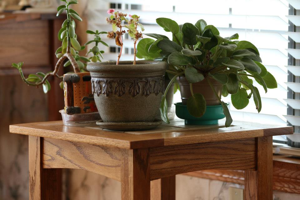

It is a simple matter to stack two or more shots in Photoshop or Lightroom.  In fact it is mostly automatic anymore.  Just a click or two. The more exposuers you take the better and more accurate your final shot will be.  This was done with just two.
Any camera can do this.

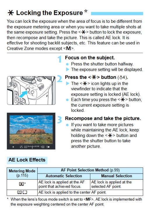

With my other camera I could simply move the exposure dot to the inside of the house and then move the camera to the actual house scene. The window would be solid white but the room would be properly exposed. That is all I want to do. But with the T7 that doesn't work.
Use spot metering and lock exposure
