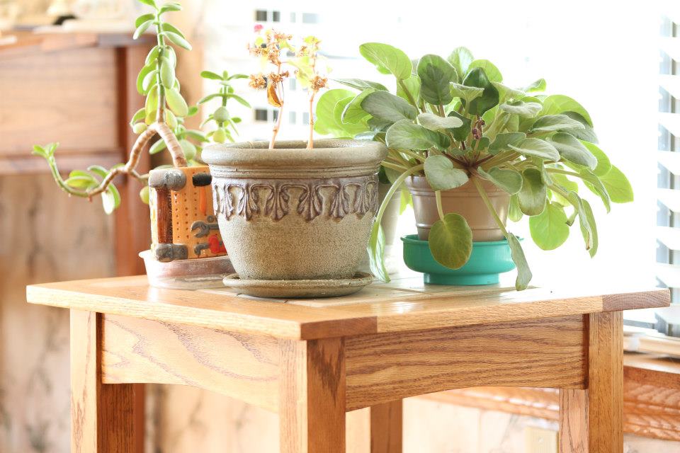

Yes it is and it is one of the photographer's best friends. All cameras have their limits. You have run up against one. You have two totally different exposure situations. That can only be done correctly with two, or more, separate exposures.
Under.
Over
Correct final done in PS.
It is a simple matter to stack two or more shots in Photoshop or Lightroom. In fact it is mostly automatic anymore. Just a click or two. The more exposuers you take the better and more accurate your final shot will be. This was done with just two.
Any camera can do this.
