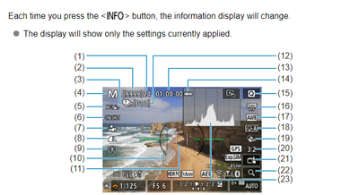

I'm not sure if he is referring to the electronic level or the AF box? But this identifies all of the still photo LCD icons:
Canon : Product Manual : EOS R50 : Information Display (start.canon)
You will not see these on an R6. These enhancements are part of the newer AF logic and algorithms on Canon's latest cameras. Similar to what all have mentioned above. 😀
