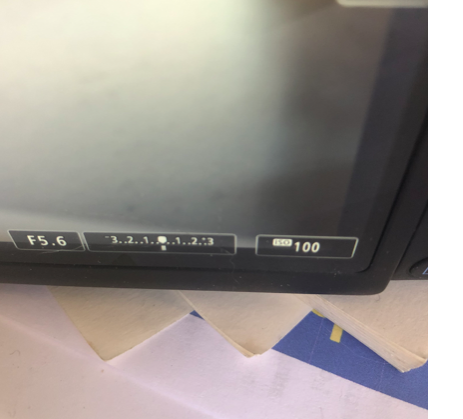

And here we are!
03-03-2021 11:30 AM
AS you can see, the camera is capturing the bright spots well but nothing else.
