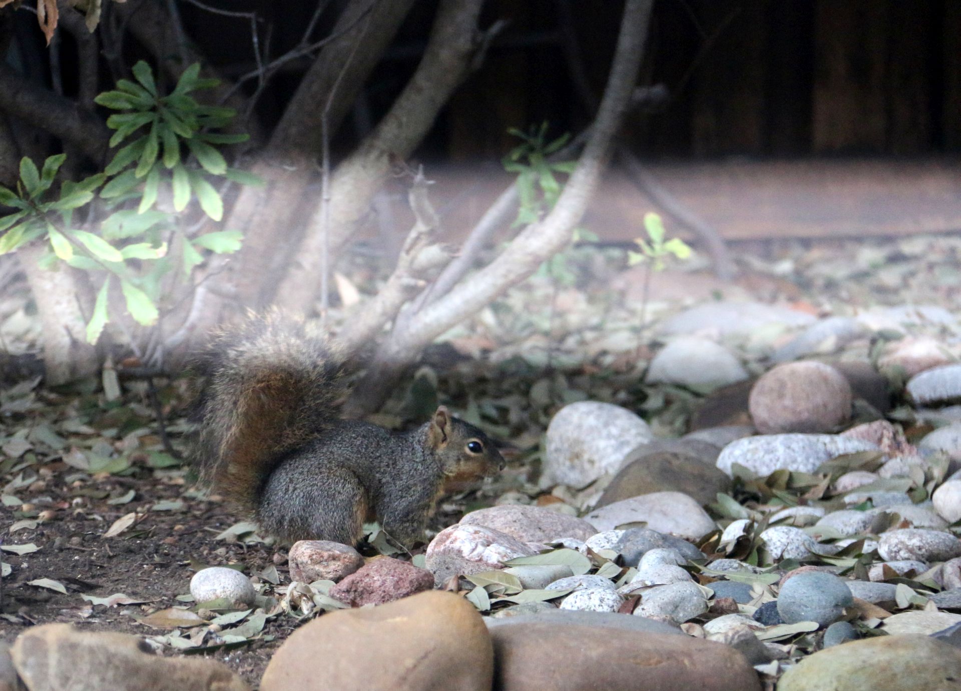

70d is producing shots with prominent white streaks! Cleaned everything. Sensor issue!? Thoughts?
LookingGlassGir
My 70d suddenly started taking shots with a PROMINENT white streak! The smaller the aperture the more prominent it is...this led me to believe it may be a dust issue ( although I have never seen dust accumulate this way) so I thoroughly cleaned everything. It didn't seem to help. Any thoughts? It seems as though it might be a sensor issue...which I would hate to replace!

It is sticking, not totally blocking.

It was a sticky shutter blade. Camera was still under warranty, so it was a free fix.

I had mine fixed at a local camera shop (Tempe Camera) for about $250 but that was over 2 years ago. They had it for about a week and replaced the shutter. I suspect the price probably has gone up. My camera is still going strong with the new shutter and I use it to shoot two or three games each week and a lot of fun stuff in between.

I think its prpbably a failing shutter.
