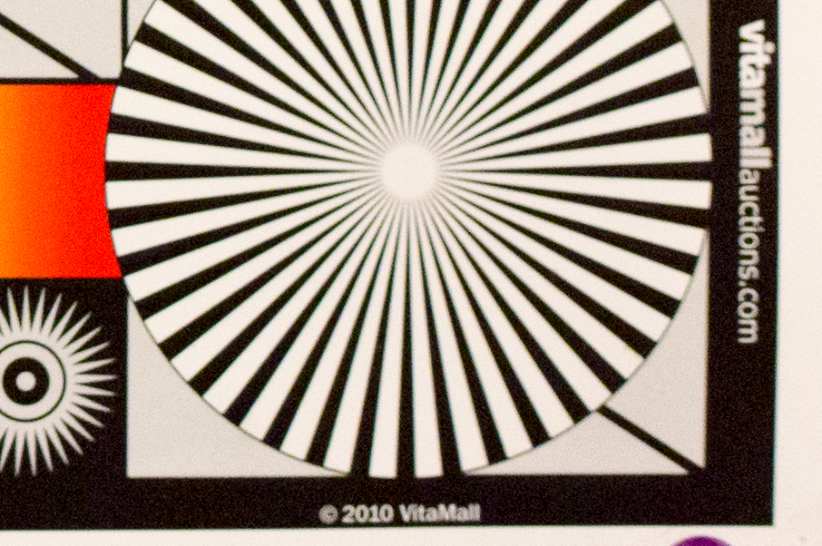

03-25-2015 10:04 PM
LiveView
03-25-2015 10:05 PM
Eyeview
03-25-2015 10:08 PM
Live
03-25-2015 10:09 PM
Eye
03-25-2015 10:11 PM
Both shots: 50mm lens, ISO 800, F4.5, 1/160

Have you tried autofocus microadjustment? The images suggest to me that that's what's needed. The focus is correct in live view, because you're looking at what the sensor actually sees. But when you use the viewfinder, the focus mechanism has to emulate the sensor via separate hardware, because the mirror blocks access to the sensor itself. If the alternate light path is too long or too short, the resulting image will be OOF relative to the sensor.

Yes I have using a program called focal
03-26-2015 03:32 PM
@dsullens wrote:Eye
Are you saying the eyeview photo above was focused in liveview, then switched to MF, and taken in 'eyeview' with mirror lock up, like you said in a previous post?
