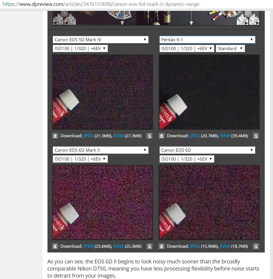

You are correct in saying that dynamic range is measured at +0EV. But then, if you do have dynamic range, it won't look like the cr*p that the 6D II produces...

OK, your ISO 6400 Canon 5DIV vs PentaxK1 comparison is accurate, but honestly I don't see how this moves the discussion at all. Canon is not ISO invariant (which is BAD), and other brands are way more invariant than Canon (which is GOOD!)
Now you presented that as if were going to be a huge surprise to me, but did you see the "Photons to photos" graph that I posted earlier on. That graph basically says the same thing... Just more succinctly. The K1 has more dynamic range until about ISO 320 - 500. From ISO 500 onwards the 5DIV has more dynamic range. But between the K1 and the 6DII, the K1 has better dynamic range all the way until ISO 2000. And again, if you think ISO 6400 is where one should be shooting photos, then good luck to you!
You mentioned the "upstream" amplification of the signal by Canon. Well, guess what, the banding that half of you pretend does not exist is directly the result of that! Canon keeps the electric analog input much longer than all the other camera manufacturers and that is exactly why some rows of pixels get hotter than others, thus producing the banding!!!
PS Your comment that at ISO 6400 Pentax has lost 6EVs of dynamic range is true but misleading. By that point the Canon 6DII has lost 3EVs, but that is not because Canon is better. The Canon 6DII started with only 9EVs of dynamic range, whereas the Pentax starts with 12. And again, shooting at ISO 6400 is terrible... Your images are going to look like cr*p no matter what!

I think you may have fallen for the deception of ISO-invariance.  Canon doesn't make ISO-invariant sensors.  Also, this is not a measure of dynamic range.
Dynamic range is measured at ISO 100 +0EV ... not +6EV.  BTW... at +6EV you lose a ton of dynamic range (that's just basic math but I'll explain a bit later).
