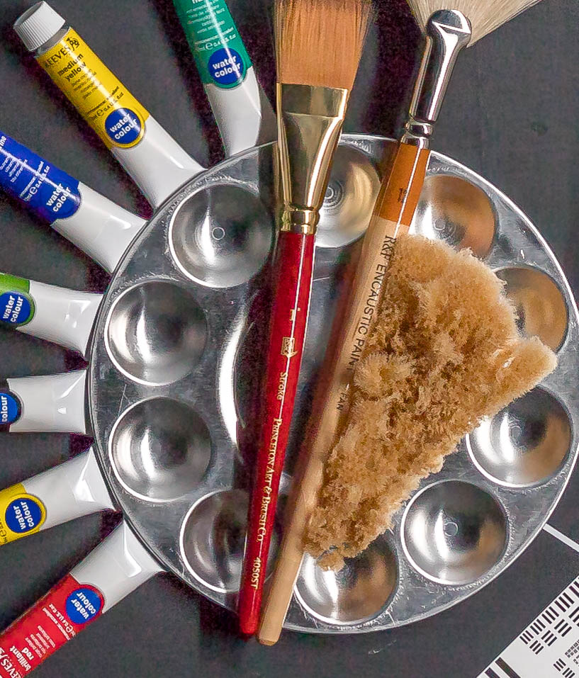

@KlausEnrique wrote:
It's been a while since I've been to Dynamic Range Review (dpreview.com). With their tabloid like headline 'Canon 6D Mark II dynamic range falls behind modern APS-C cameras' no wonder you're upset. There is no need to be.
It is well known that Canon has RAWer RAW files, that don't contain baked in noise reduction. It should also be abundantly apparent that other manufactures are baking processing into their RAW files. So comparing unprocessed RAW files becomes meaningless.
The loss of detail/softening on the D750 due to the baked in noise reduction is apparent in complex detail of the sponge.
With the Canon RAW file you have the option of applying the noise reduction or retaining the detail. Or with selective processing you can do both.
The below photo is the processed version of the Canon 6D Mk II +4 EV RAW file from above. I believe I was able to maintain more detail in the sponge while selectively applying noise reduction to areas without detail than Nikon did with their baked in processing.
When Nikon bakes in their noise reduction they take that control away from you.
If that control is not important to you than sure go buy a Nikon or another manufacture's camera. If you want to be able to make the decisions in the post processing using Canon's RAWer RAW file, realize that control means that Canon won't look as good comparing Canon's RAWer RAW to Nikon's RAW, nor will Canon' score as well on 'the test'.
