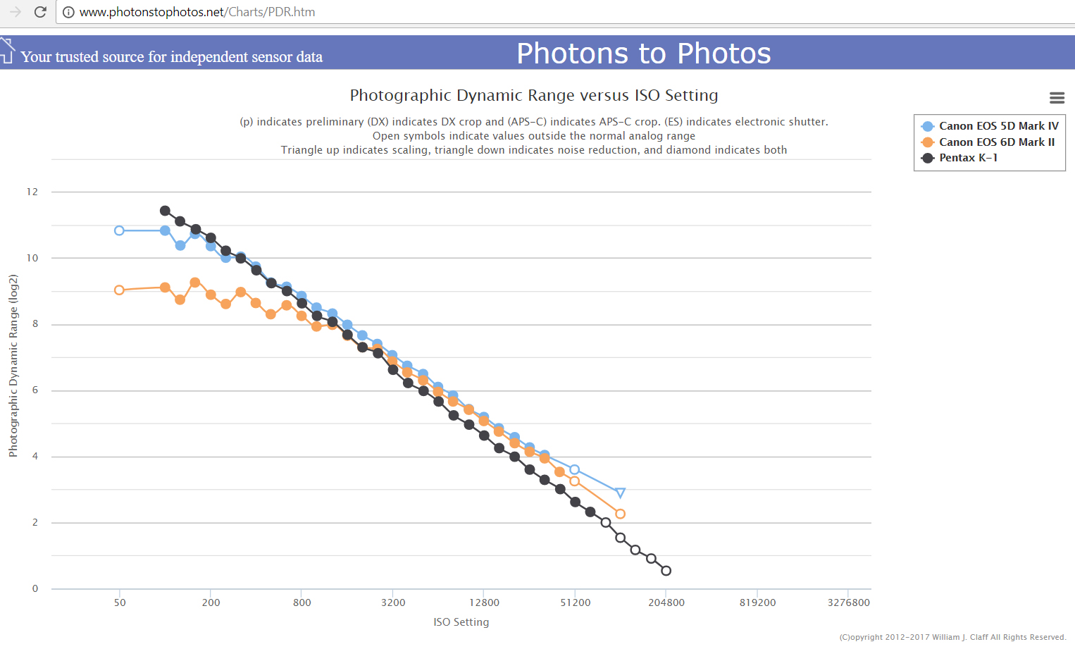

You are correct in saying that dynamic range is measured at +0EV. But then, if you do have dynamic range, it won't look like the cr*p that the 6D II produces...

Dynamic range is measured at ISO 100 +0EV ... not +6EV. BTW... at +6EV you lose a ton of dynamic range (that's just basic math but I'll explain a bit later).

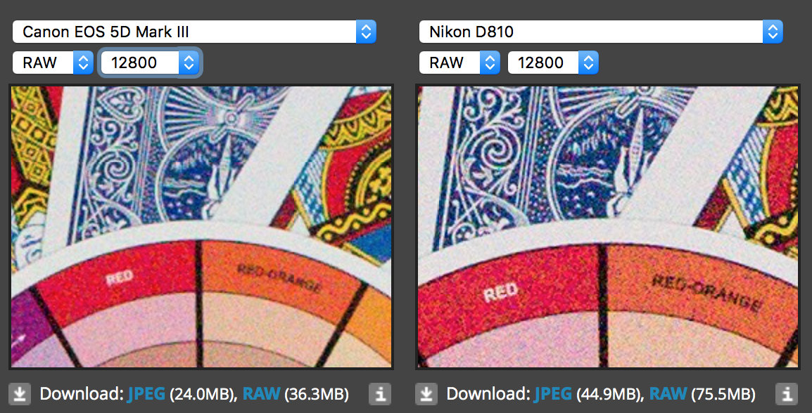

So let me short-circuit your brain for a moment.... have a look at this:
The image on the left is just a tad cleaner than the image on the right. Did I photoshop this? Why should such an image exist? What's going on here?
What's going on is... nothing. This is an honest comparison of what happens when you dial a Canon 5D IV to ISO 6400 and then dial a Pentax K-1 to ISO 6400 and don't shoot at ISO 100 and do a +EV boost in software on your computer.
But that's not all... the ISO invariant sensor would have been losing DR for each stop of ISO gain... but the Canon sensor woud resist the loss of DR until the boost exceeds the amount of upstream gain they apply. If you boost an ISO-invariant camera by +6EV then you lose 6 stops of DR. A Canon camera such as a 5D III or 5D IV would have lost about 1.5 stops... maybe just 1 stop.
PopPhoto (tragically no more) used to show the DR for every stop of ISO (DxO only shows it at ISO 100) and it became evident that as soon as you start boosting ISO, the ISO-invariant sensors immediately start losing DR. The Canon cameras always trade-places on the DR rank when you do that ... they have more DR at high ISO (because they apply "upstream" gain).

If a camera has 10 stops of native dynamic range and it's an ISO-invariant sensor (which means it really only ever shoots at ISO 100 and uses math to manipulate the output) then when we go to +1 EV, we just dropped the camera's DR down to 9 stops. Every stop we boost ISO is traded for a loss of 1 stop of DR.
But wait... lots of ISO invariant cameras claim to have more DR (well... they do if you believe DxO -- I am not a beliver in DxO because I can do math).
The trick is to compress the data. So instead of boosting ISO straight across the board (e.g. think of Ansel Adams' Zone System... but lets reduce it to just 5 zones). We can't really double the top zone (zone 5) because we'd get clipping... so we pretty much do nothing. Then we take zone 4 and we only try to fractionally boost it... zone 3 gets a slightly larger fraction of a boost and so on... zone 1 (the darkest zone) gets a full doubling.
Really we've just "compressed" the DR... so that 5 stops of true DR are squeezed to fit into 4 stops of DR. But that doesn't avoid the fact that it's really just 4 stops of DR. You could do this in Lightroom by adjusting the black point (instead of adjusting the exposure value).
Lots of cameras have features that try to do this for JPEG photos ... Canon calls it "highlight tone priority" (squeeze the DR to avoid blowing the highlights... but still bring up the blacks).
By the way... these tricks apparently fool DxO. They don't fool me because... well, I can do math.
A Canon 5D III (and I haven't tested my 5D IV) is going to boost about 5 stops of ISO before it really starts losing any significant DR ... BECAUSE... Canon does "upstream" amplification. This causes a boost to ISO at the analog level so that it doesn't have to start the digital multiplication.

I ran into this on another forum where someone was trying to explain how much better than Nikon D810 was by showing ISO-invariance tests (completely unaware that this kills DR). I pulled the following samples from DPReview tests.
His response was to scoff at these because one is ISO 25600 and the other is ISO 12800 and he felt that was unrealistic and "nobody shoots at those ISOs".
Fair enough... let's pull data from something with less ISO gain... I pulled another test comparison and this one at ISO 3200.
These are just honest results that you get when you operate these cameras at these ISO values and pull the images straight out the camera and don't manipulate them and don't use ISO 100 images and try to boost it by many levels of EV (I don't know photographer who does that... so why do they keep showing those tests)?
Lastly... did you happen to notice that the last batch of images ... the Canon camera was actually a 5D III (the 5D IV is better... but he was ranting on about the 5D III).
