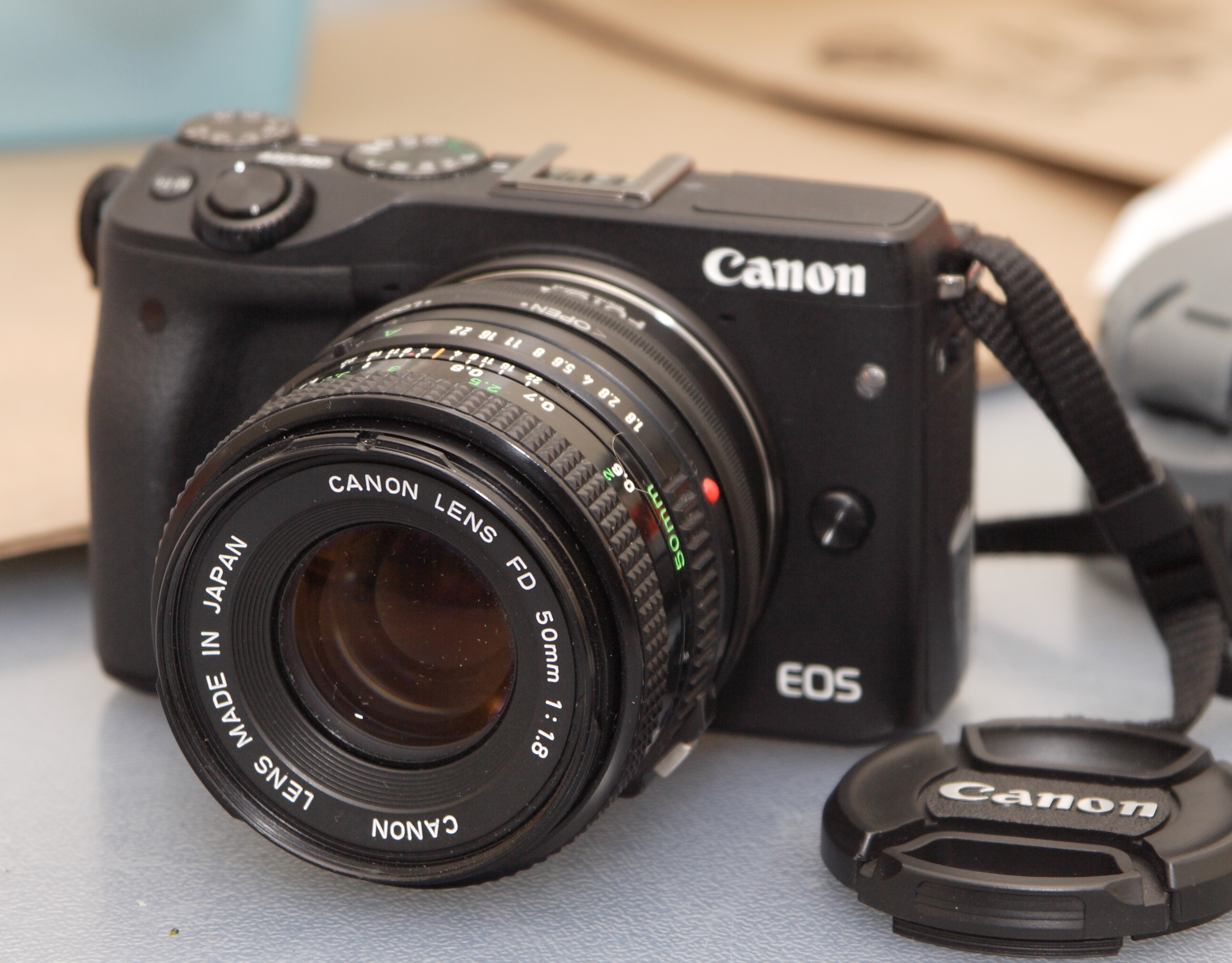

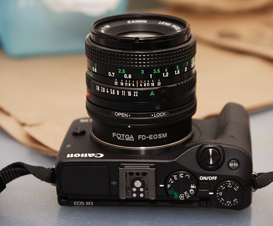

Any of Canon’s M series mirrorless cameras will work quite well with FD lenses using a simple adapter with no optics.

We know of no good adapters for the EOS EF and EF-S mounts. The only viable solution is MikeSowsun's: an M series, though it is not a DSLR.
