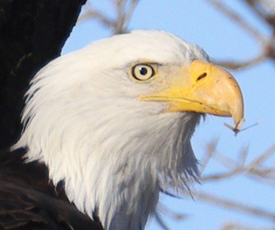

100% crop:
100% crop100% crop

My one word answer is no don’t do it. Of course it depends on what you are good with. And how you intend to use or view your work. The eagle crop is soft but who does 100% crops as a normal final product. It’s actually pretty good if it was the 100-400mm and tel-con.

It was in fact made using the 2x extender which degrades the image more than the 1.4x. It was not possible to get closer to the eagles so this photo would not have been possible hand held from a car window without the extender.
