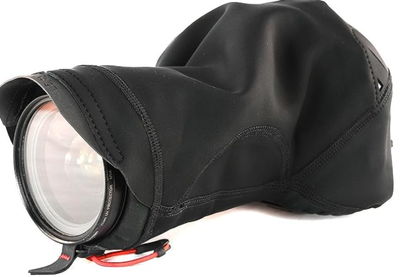

I think some of this depends on your gear.  A clear lens filter is a good start.  Neoprene lens sleeve?  Something similar to spandex or thin wetsuit like material.  Other protective measure > CarePaks.  Soft bristle brush, rocket blower.  No lens changes outside.

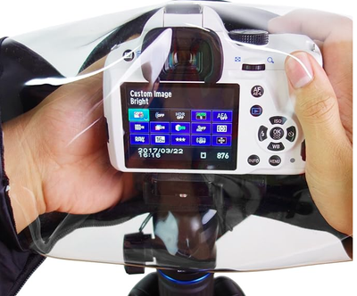

I have put my camera in a large freezer bag. You can cut a hole for the lens to stick out and use gaffers tape to secure it. If sand is that bad I would explore the idea of wearing a mask for myself.
