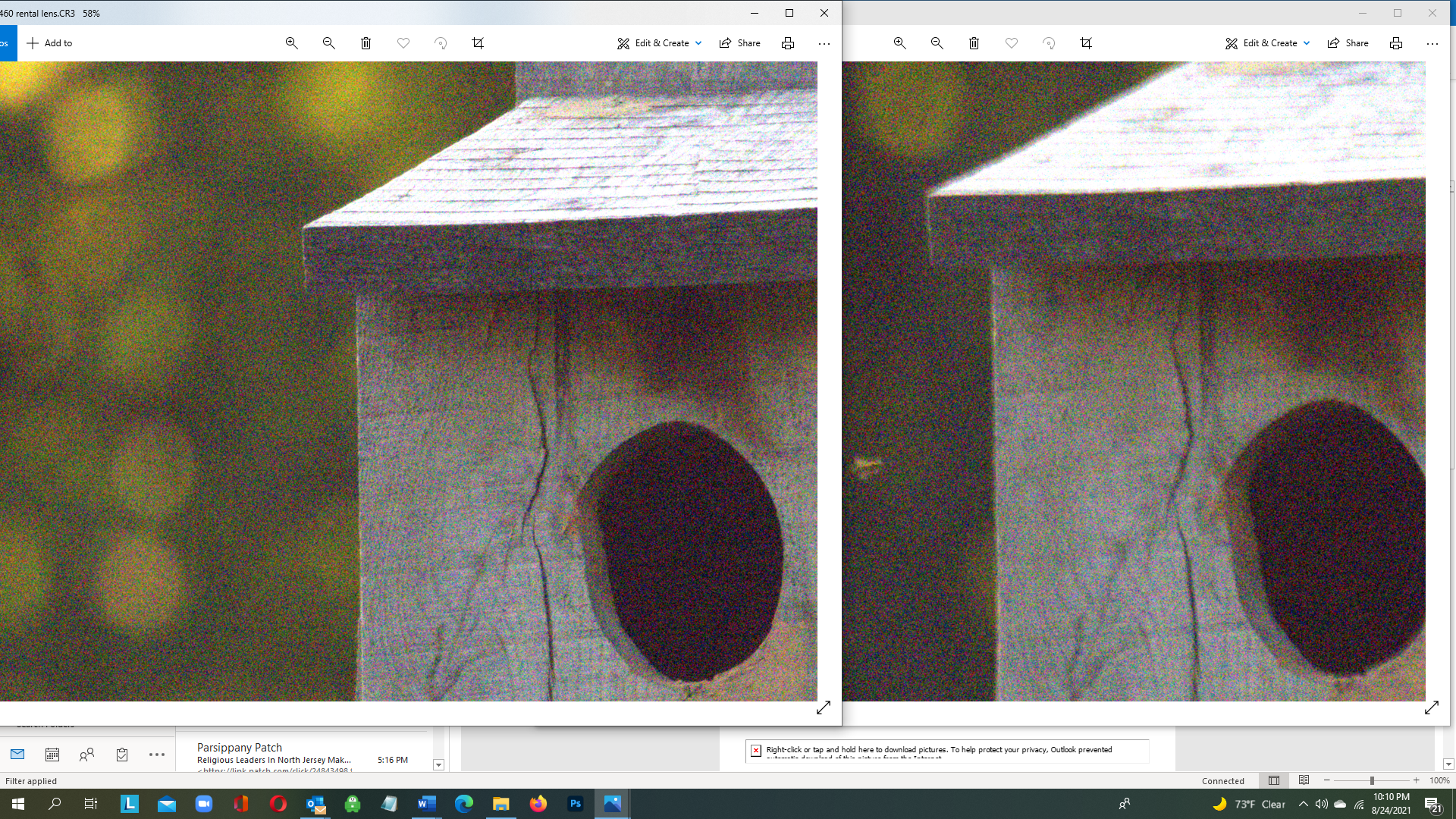

This comparison of a bird house, hand held is the Canon Raw files... You can see the ringing or ghosting of the image on my lens on the right side at the roof of the bird house. The rental lens is spot on. You may need to zoom into images.

I'm convinced. You have a bad copy. Contact Canon Support to arrange a service ticket.
