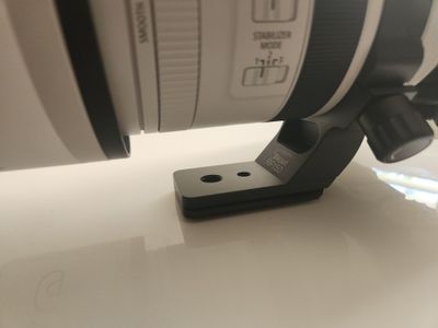

12-12-2024 05:43 PM
I have the same issue. It's a bit annoying really. I like to shoot pics of the moonrise / moonset over Manhattan, and after getting my composition and getting the horizon straight I don't want that to change. It is too loose to feel secure. I found a replacement by Leofoto CFC-01. I ordered it. Let's see if it's tight. Disappointed that Canon could not get a locking collar on there like my old Sigma 60-600 had.
12-18-2024 11:44 AM
Got the Leofoto Lens Collar. Amazing product. Very happy with it. Locks down tight. Arca compatible foot. :). Problem solved.
