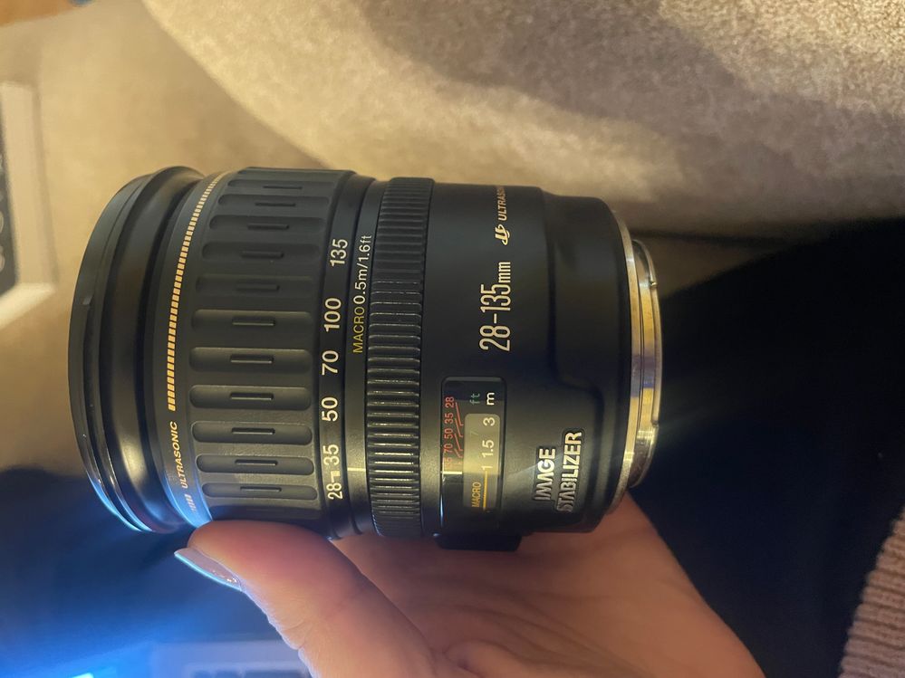

Hello!
I currently have a Canon EOS Rebel t7 and a few lenses I've purchased. My dad recently gave me his old camera, an EOS Rebel xs, and a bunch of lenses with it. Is there an adaptor that I can purchase to make the lenses that worked with his Rebel xs work with my Rebel t7? The lenses are a close fit, but not quite the same size.
I appreciate any and all help!
09-25-2024 07:32 PM
@goodmann wrote:
I think I identified the issue -- I think there is slight damage to the lens mount. A little bit of the metal is slightly bent in one area. I was lining up the dots and it was not working. However, this would explain that!
09-10-2024 10:18 AM
What is the exact wording on the lenses. Look on the very front of each lens and report back. You should see something like EF 50mm 1:1.2L.
09-24-2024 06:00 PM
One of the lenses that does not work for my Canon EOS Rebel T7 says "EF 28-135mm 1:3.5-5.6 IS"
09-25-2024 12:12 AM
Goodmann......
Just to make it clear.....Your Rebel T7 camera can take ANY and ALL EF and EF-S mount lenses ever made. If you try one that does not fit it's because the mount on the lens is damaged. Forcing a damaged lens onto the camera can damage the camera's mount too. Be careful.
