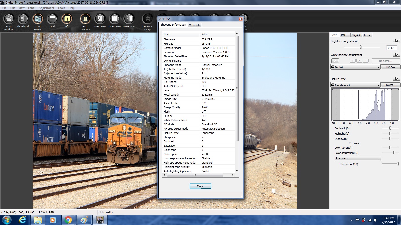

I've had this lens for a while, using it on my 650D, and I'm not loving the results. I'm finding that at almost all focal lengths, the edges are just plain blurry. I know that few lenses are sharp throughout the frame, and I don't expect "L" quality but what I'm seeing doesn't seem acceptable. Yes, you get what you pay for, but even my old 28-80 USM was better than this 18-135. (Sometimes I wish I would have kept the 28, even though it's not really wide enough for a crop body.)
The middle of the frame consistently is very sharp. I've tried stopping down (usually to no more than f/8) turning the IS on and off, and try my best to avoid camera shake. My shutter speed rarely is less than my focal length. Could my AF method have something to do with it? I usually stay on AI Servo. I've tried manual focusing, but with the Rebel's smaller viewfinder, it's not easy and all of the times that I've tried MF, the results have been equally disappointing.
Could I have just gotten a bad copy? Decentering issue? Or is something that I'm doing wrong?

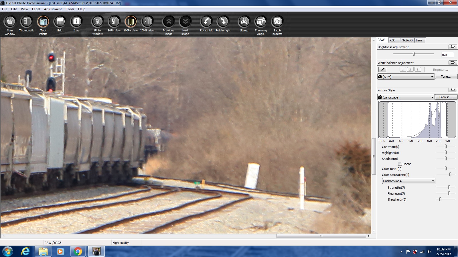

I forgot to mention, in case it's not apparent, that the third pic is a 100% crop of the right side.

I don't think you need to use AI Servo for this type of shot. One Shot mode should have been good enough. Your shutter speed seems to have been high enough to freeze the train. I suppose it was not moving at a cruising speed.
http://www.dofmaster.com/doftable.html
What would you estimate the distance between the camera and the train to be? According to the chart at the above link, you could be seeing the far edge of your DOF. I wish your crop were a little larger, to include some of the dome in the background.
If you say all shots are blurry around the edges, then I will take your word for it. But, I suspect this particular shot is close to the edge of your DOF, or your hyperfocal distance. It's hard to tell. I'm comparing stuff to the left to the engine, to that to the right of the engine.
Try taking shooting in One Shot mode, both with and without IS active.

I may point out, you took the worst part (right edge and behind) of your shot for IQ and enlarged it to pixel level. Also an extreme condition.
Switch your shooting mode to One Shot. There are few, very few, reasons to use AI-Servo certainly not this one.
The only way you can confirm the IQ of a lens is with a test target and a dedicated series of tests..

@Waddizzle wrote:What would you estimate the distance between the camera and the train to be? According to the chart at the above link, you could be seeing the far edge of your DOF. I wish your crop were a little larger, to include some of the dome in the background.
Wadizzle, I can post another crop if you think it may help. I would estimate that I was about 100 feet from the train, which was traveling 23-25 MPH, for what it's worth.
For a while, I was using AI Servo for some sports work, and it seemed to work for moving trains, especially ones that were head-on shots where the the train was coming straight at me. Maybe it works better in different situations.
Well, maybe that statement was a bit of an exaggeration on my part. I'll admit to becoming a pixel peeper lately. It's just kind of frustrating because I've seen the work of a few of my friends who are using this exact same lens for the same type of (RR) photography and their stuff is completely sharp throughout the frame and I wonder why quite a few of my shots aren't. I know that cropping the soft/blurry edges is an option, but I try to avoid it doing so wherever possible.
I've taken 400-500 shots with this lens since I got it last summer. I may need to just take it on a day trip and take 400-500 shots just in a single day at a variety of settings and see what works best. Maybe it is something in my technique.
Heres another that I took last week, this time at the long end, with a 100% crop of the right side. I noticed that for this one, I had switched over to One-Shot AF. Maybe it's just me, but the right side doesn't just look soft, it looks blurry. Again, I understand that the extreme edge isn't going to be as sharp as the middle, and it's on the edge of the DOF, but I think it could be much clearer. All of the detail just seems to run together.

I'm not certain what you used as your focus point. The hyperfocal distance of a 35mm focal length at f/8 is about 27'. If the camera focused on anything nearer then that would explain the issue.
Also, a lens doesn't necessarily have a "flat" focal plane. It's typically just slightly curved and a bit closer at the corners than it is in the center (although lens designers do try to compensate for this to create a nearly flat field.)
I'd be interested in knowing how those tree leaves in left edge of frame look as well as a how the center looks (it'd be easier to judge this using the original out-of-the-camera image.)
If you look at the meridonal performance at f/8 for your lens at the 'wide' end (visit this page and click the "more" link at the end of the description to expand the page to show the full description, sample images, and MTF test curves) you'll see that the lens does have quite a noticeable fall-off in it's ability to resolve fine detail at the edges and corners of the frame (in other words, some loss of detail resolving is normal.)
There are other factors that can certainly come into play such as camera motion of a hand-held camera. But your shutter speed was 1/640th at a 35mm focal length -- which is extremely good (you should have no difficulty hand holding a 35mm at 1/640th ... even if the lens didn't have image stabilization). So I doubt that's the issue (I suppose you could blur it with motion, but you'd almost have to be trying to move the camera while taking the shot.)
BTW, the blur I see seems to be along the radial direction (from center point radiating to the outer edges and corners). Such a blur would cause a poor score on the MTF curve for the "meridonal" direction. On the Canon MTF curve, you'd want to look at the blue dashed lines. There are two such lines... one thick, the other thin. The thicker line shows performance using the thicker/bolder test lines (with larger gaps between lines) on an MTF test chart. The thinner lines shows the performance using the finer lines (with narrower gaps) on the test chart. Basically the finer line shows how the lines can resolve finer levels of detail.

I am surprised to hear you say that you were 100 feet from the engine in the original shot you posted. At a 35mm focal length, it looks more like 2 car lengths or less, or somewhat less than 50 feet, possibly close to 30 feet. A distance of 100 feet is pretty far. A basketball court is 90 feet. Baseball bases are 90 feet apart. Do you think that you were farther away than that?
How sharp is the front of the train, or wherever the focus point was established? You will get your best results on most shots by using One Shot mode, and using the center AF point.
What is the full model number of your lens? The STM version of the lens is pretty good, but sharpness does fall off. I still think most of your issue is related to depth of field. These photos are not very good for evaluation as "test shots". There are images that you can download and printout to use as test shots. But, I have used the lines of a large empty parking lot to test super telephoto lenses. The lines that define parking spaces are evenly spaced, and at known distances apart.
I think your lens is operating properly. It is human nature to reject that which we do not understand. But, it is quite possible that you are more likely seeing the limits of your photography skills, than the limits of your gear. Your evidence that your lens is not performing well, raises more questions than resolving them.
