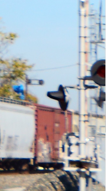

I've had this lens for a while, using it on my 650D, and I'm not loving the results. I'm finding that at almost all focal lengths, the edges are just plain blurry. I know that few lenses are sharp throughout the frame, and I don't expect "L" quality but what I'm seeing doesn't seem acceptable. Yes, you get what you pay for, but even my old 28-80 USM was better than this 18-135. (Sometimes I wish I would have kept the 28, even though it's not really wide enough for a crop body.)
The middle of the frame consistently is very sharp. I've tried stopping down (usually to no more than f/8) turning the IS on and off, and try my best to avoid camera shake. My shutter speed rarely is less than my focal length. Could my AF method have something to do with it? I usually stay on AI Servo. I've tried manual focusing, but with the Rebel's smaller viewfinder, it's not easy and all of the times that I've tried MF, the results have been equally disappointing.
Could I have just gotten a bad copy? Decentering issue? Or is something that I'm doing wrong?

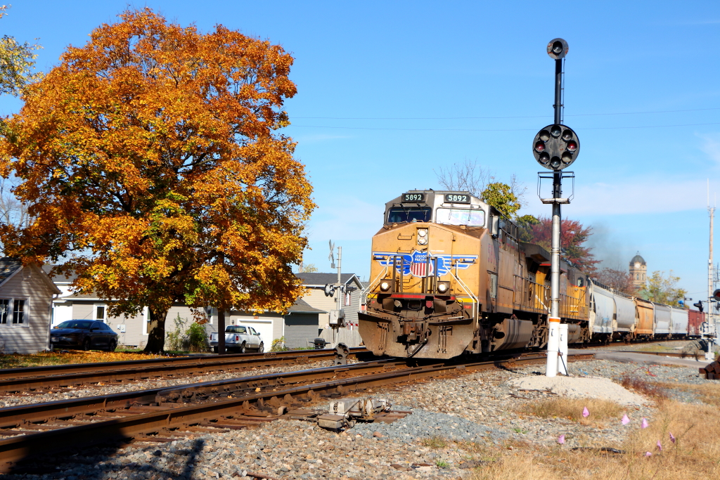

I'm not certain what you used as your focus point. The hyperfocal distance of a 35mm focal length at f/8 is about 27'. If the camera focused on anything nearer then that would explain the issue.
Also, a lens doesn't necessarily have a "flat" focal plane. It's typically just slightly curved and a bit closer at the corners than it is in the center (although lens designers do try to compensate for this to create a nearly flat field.)
I'd be interested in knowing how those tree leaves in left edge of frame look as well as a how the center looks (it'd be easier to judge this using the original out-of-the-camera image.)
If you look at the meridonal performance at f/8 for your lens at the 'wide' end (visit this page and click the "more" link at the end of the description to expand the page to show the full description, sample images, and MTF test curves) you'll see that the lens does have quite a noticeable fall-off in it's ability to resolve fine detail at the edges and corners of the frame (in other words, some loss of detail resolving is normal.)

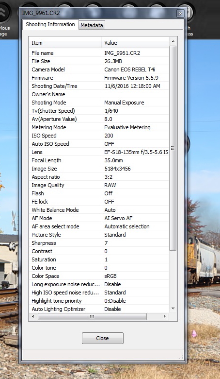

There are other factors that can certainly come into play such as camera motion of a hand-held camera. But your shutter speed was 1/640th at a 35mm focal length -- which is extremely good (you should have no difficulty hand holding a 35mm at 1/640th ... even if the lens didn't have image stabilization). So I doubt that's the issue (I suppose you could blur it with motion, but you'd almost have to be trying to move the camera while taking the shot.)
BTW, the blur I see seems to be along the radial direction (from center point radiating to the outer edges and corners). Such a blur would cause a poor score on the MTF curve for the "meridonal" direction. On the Canon MTF curve, you'd want to look at the blue dashed lines. There are two such lines... one thick, the other thin. The thicker line shows performance using the thicker/bolder test lines (with larger gaps between lines) on an MTF test chart. The thinner lines shows the performance using the finer lines (with narrower gaps) on the test chart. Basically the finer line shows how the lines can resolve finer levels of detail.
