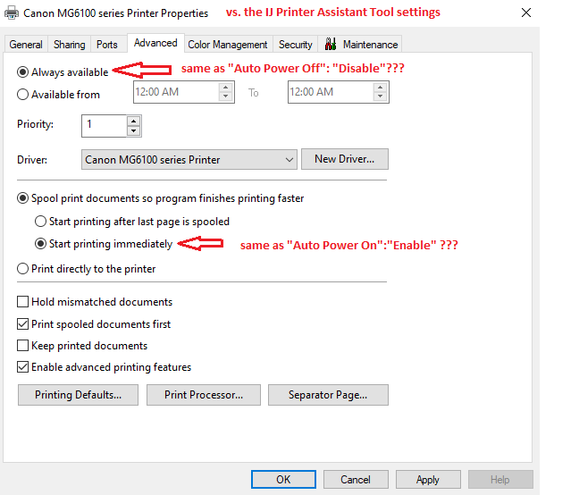

As a follow up to the question of using a "power saver mode" or "turning off the printer" to save ink used by the "cleaning and/or alignment" that is performed whenever the printer is turned back on after it has been turned off:
I just bought a TR8620a printer and was looking at the "Auto Power" settings in the IJ Printer Assistant tool - specifically the option to "Disable" the "Auto Power Off" feature (see screen shot). I assume that by disabling that feature, the printer will remain "on" continuously.
What I'm not sure about is: does it still go into some sort of low power mode/power saver mode? - or is it really fully on - with even the LCD panel lit up? Is there a built-in safety to cap the print heads to keep them from drying out?
I have an MG6120 that would use up ink if it was "asleep" or "off" for an extended period of time, and I'm looking to find the best/safest way to prevent that with my new printer.
I've searched the manual and Googled it and it seems most would say "leave the printer on" all the time - but I don't know if there are any drawbacks in doing that, aside from using more electricity. I couldn't find a setting that specifically said "Power Saver".
Any help/clarifications would be greatly appreciated. Thank you.

Hi John,
Thank you again for the extra info and insight. I took a little time double checking power setting options on my old MG6120, which is also only connected with a USB (no Wi-Fi). The only similarities I found in the MG6100 series "Printer Properties" dialog box >Advanced, were like the "Auto Power On and Off" settings in the IJ Printer Assistant Tool - I marked up a screenshot for the specifics (to compare against screenshot attached in previous email).
So, I guess the "final answer" for me is to leave the printer on all the time, thus postponing/reducing the number of cleaning cycles. As you noted with your Pro series printers, the TR8620a needs to be "awake" so it can recognize when a print job is being sent to it (as opposed to listening for a Wi-Fi wake-up call in your case).
Apparently no harm is done in terms of things "drying out" when the printer is left on 24/7. Thank you for letting me know that the LCD screen does go dark even under those conditions. Whatever sleep mode/power saver mode the printer goes into is not easily found in the online or PDF version of the manual.
