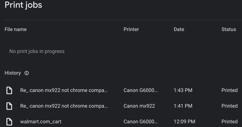

07-04-2023 02:51 PM - edited 07-04-2023 02:56 PM
I recently found a configuration file on reddit that makes it possible for the mx922 to work with a Chromebook.
You can find the PPD and the directions by searching:
reddit:I made a Canon MX922 PPD file that works on Chromebooks
