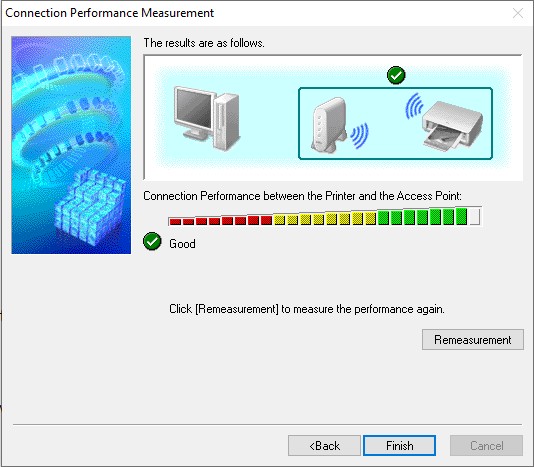

Also for your interest, this is the result of the Wireless signal connection test, and advanced test on the scanner.. no problems with connectivity.
Performance check gives Sig.Strength 97%, Link quality 100%... advanced test, see attachment... but still the same stupid delay, unless reinstalled prior to trying to scan.
Honestly seems to me to be some sort of software issue with the MP Navigator, as each time it is started, very slow to come on.. (using the wireless connection) and then this long delay with scanning. If I set it to USB and use that, no problem, quick start, and immediate response.MP Navigator install is latest, 4.03 ( filename mpnx_4_0-win-4_03-ea23_2.exe
