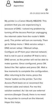

I experienced the same issue with my MX490. The temporary solution I found was to block the printer from internet access to get it to function. I have the printer working now via a USB connection to my computer. I'm not sure if all the Canon models are being hacked that are connected via WiFi.

I had the same issue for a printer MX492 PIXMA bought in Canada 4 years ago, worked perfectly yesterday and turn on and off continuously today on may 31, with non action to do. The best solution to fix this issue was indeed to remove the access to wifi, everything works like before. If you turn the wifi on, then the issue starts again. This issue has really to be solved by Canon! Now my printer works, but nothing can be printed form smart phones.

I have the same printer and had to do the same thing...hook it up wired with USB in order to be able to use it, but only from my computer, since my wireless devices can no longer see it. This is not the fix I hoped for.
06-01-2022 09:44 AM
Update: It only works when I have the Internet off. I re-installed the printer drivers in order to configure the printer through the hard cable. But it didn't solve the cycling/restarting problem.

If I turn my router off all the buttons on the printer work and therefore I can copy pages but as soon as I turn the router on again all the buttons are frozen. I need to be able to print dance sheets off the internet wirelessly so I have gone out and purchased another printer as I can't wait for ever for Canon to provide a fix. The new printer works perfectly.
