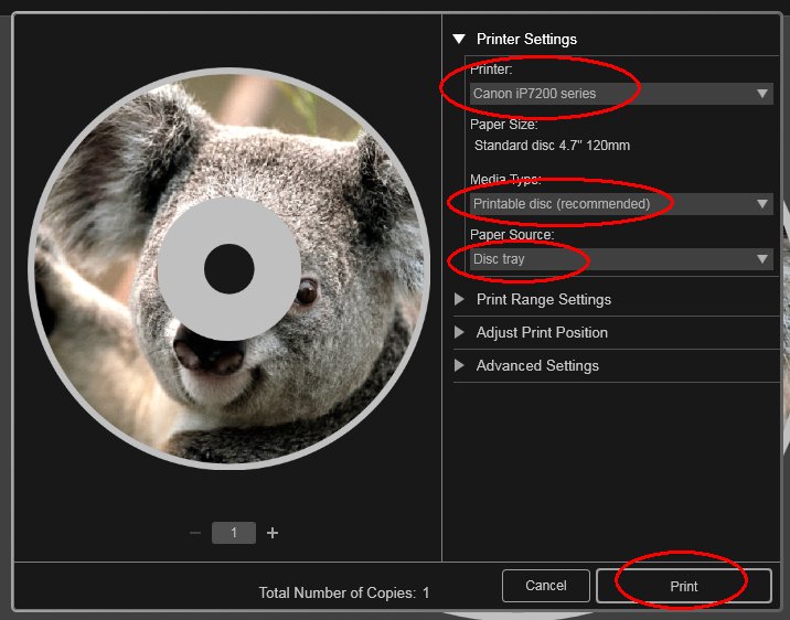

Please open My Image Garden and follow these steps:
1. Click on New Art at the bottom and then Disk Label.
2. In the Design List, let's try "Simple 2".
3. At the bottom of this pop up window, next to Paper Size, please select Standard disc 4.7" 120mm.
4. Click OK.
5. A new disc image will appear. At the bottom, click "Add Image".
6. Select an image from your computer.
7. The image that you selected will appear as a thumbnail at the top of the window. Click and drag that to the disc below.
8. Click Print. The Print window will appear.
9. Make sure that the print settings are set correctly and click Print in the lower right hand corner.
There is no "New Art" icon in the location shown in your illustration.
The manual instructs me to open "My Art", but that button is grayed-out.
If I go to my hard drive and select an image, the image appears inder "My Art",
and then I can open My Art.
I don't get that list.
I don't get asked for "paper size" until I click "Print".
The size you indicate -- "Standard disc 4.7" 120mm" is not one of the choices on the drop-down list
I am presented with.  Instead, I have standard paper sizes like 8-1/2x11; A4; etc.
______________
4. Click OK.
None of this stuff happens.
When I pull the image into "MyArt" and try to procede, I am asked to select a "theme" form a list of pre-defined images, and to "register people", whatever that means.
I have tried selecting from the built-in lists for these, and then I get to where I can select "Print" -- but once again I'm asked to select paper size, and the 4.7" disc is not among the choices.
