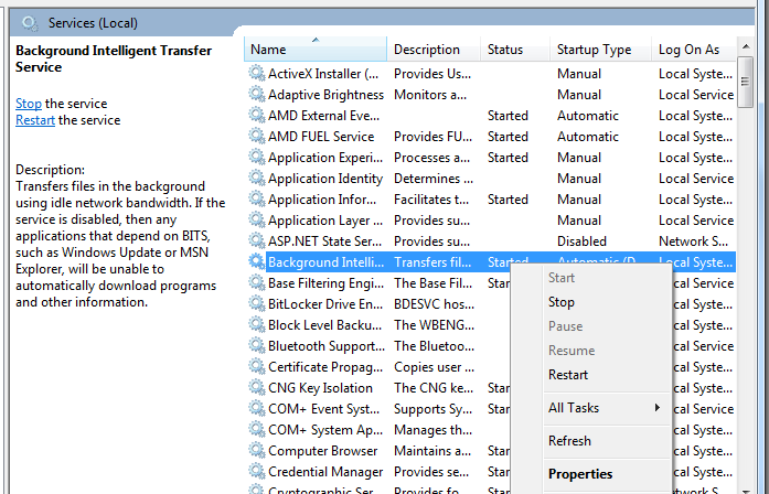

After checking back through different problems people have had with other canon printers, I attempt running as administrator with the BITS service restarted, with the BITS stopped, and with the BITS restarted for good measure. Any variation of BITS has no apparent effect on the installer's ability to find me drivers, always just giving me the same ol' Failed to Acquire information on the driver and software pictured above.

The other stuff you are trying with the BITs service is unrelated, and does not apply in your situation. In addition, if the user profile you are logged in with has local admin permissions, you do not need to right-click and select "Run As Administrator" from the context menu. This is assumed.
