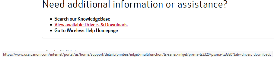

Screenshot_2021-05-12 Support TS Series PIXMA TS3522 Wireless All-in-One Printer Canon USA.png
I go down and root through the bottom links on that page looking for driver support and it always links me to drivers for a different model printer, the Pixma TS3320 (You can see the mouseover url at the very bottom of my attached pic). Attempting to install that driver always fails because the Pixma TS3320 installation utility fails to detect the Pixma TS3522, which kinda makes sense.

Is there something obvious I've missed? I've read in places that I need to get the direct drivers rather than an installer for the drivers but I'm completely unable to find them anywhere on the Canon site right now. It just sends me through an endless loop that directs me to the wrong printer model or the wrong printer model driver installer again and again and again.

I can confirm that something does appear to be wrong with the product's support page.  Pressing Get Support should take you to another page with a drivers and software tab with a OS selection dropdown.  This appears to be missing.   So you are not losing your mind.
The drivers file you did find appears to be correct...  ts3500_mcd... for windows.  Best I could find is below...  this includes a link for download.
