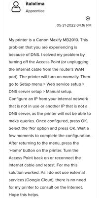

Your satisfaction is important to us, and we apologize for any inconvenience you may be experiencing. A firmware update is available to fully resolve this issue. You can download the firmware update and find easy installation instructions at canon.us/power.

06-01-2022 02:07 PM
Don't buy a new printer. Disconnect the Wi-Fi and the power will return as normal. I recommend wiping the settings, i.e., performing a factory reset using the printer menu, to prevent it from connecting again.
Although, yes... if a new printer is needed, it certainly won't be a Canon ever again for me.
