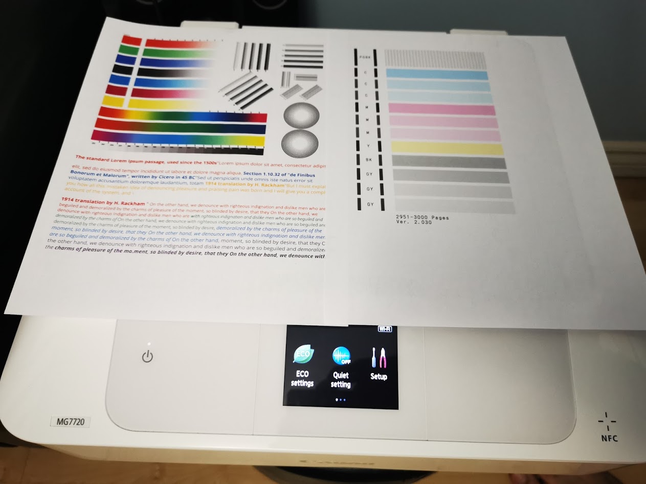

My MG7720 printer got the printhead squares double walls but printing all the colors somehow ok. Doing an automatic and manual cleaning made the colors better but the lines at the top of the page were still double - issue reflected in the text as well. Many rows are printed with double letters.
Talking with Canon support I ended up ordering a new printhead & set of ink cartridges - which did solve the issue with the double letters but now my printer print NO Colors at all. As you can see in my Nozzle Check below, no colors are coming out. Nothing with the old printhead, nothing with the new printhead. Brand new ink cartridges, regular cleaning, deep cleaning, nothing works.
The only error I have is when I do an Automatic Printhead Alignment I get the 2500 error as is in the below screenshot. Anyone any idea what's wrong with this printer?

Unbelievable I was able to figure this issue out.
Thinking that this printer was not working properly not even with the original or a new printhead I've decided to buy a new printer, the same MG7720 since I had the new printhead as well as some ink.
The new printer came today and I did a printhead swap between the old and the new printers and everything works well on both printers. All this issue was an incompatibility of the new printhead and my old printer.
If you end up in a similar situation try a different printhead - it did work well for me!

You said you "swapped heads" but then why did the old head work in the new printer? And aren't you stuck with a new printhead that won't work in either one? Did you order the wrong printhead or did Canon or another vendor sell you the wrong one, and will they refund the error?

I have no idea why the old printhead works on the new printer... But, I think I'll just keep them like that for now, it works perfectly. It was strange to have the old printer not printing color even with a new printhead, I'm glad I didn't put it in the garbage before getting the new printer. 🙂
The original printhead was printing double-letters, and that's the extra printhead I had (I already throw it since wasn't working properly) - but I didn't try this again since was defective.
I bought the new printhead from Canon Canada, and it was strange that wasn't printing color since it was new. But as soon as I've swap it with the printhead from the new printer it worked perfectly. I assume one of the contacts was not connected properly... Can't really tell...
