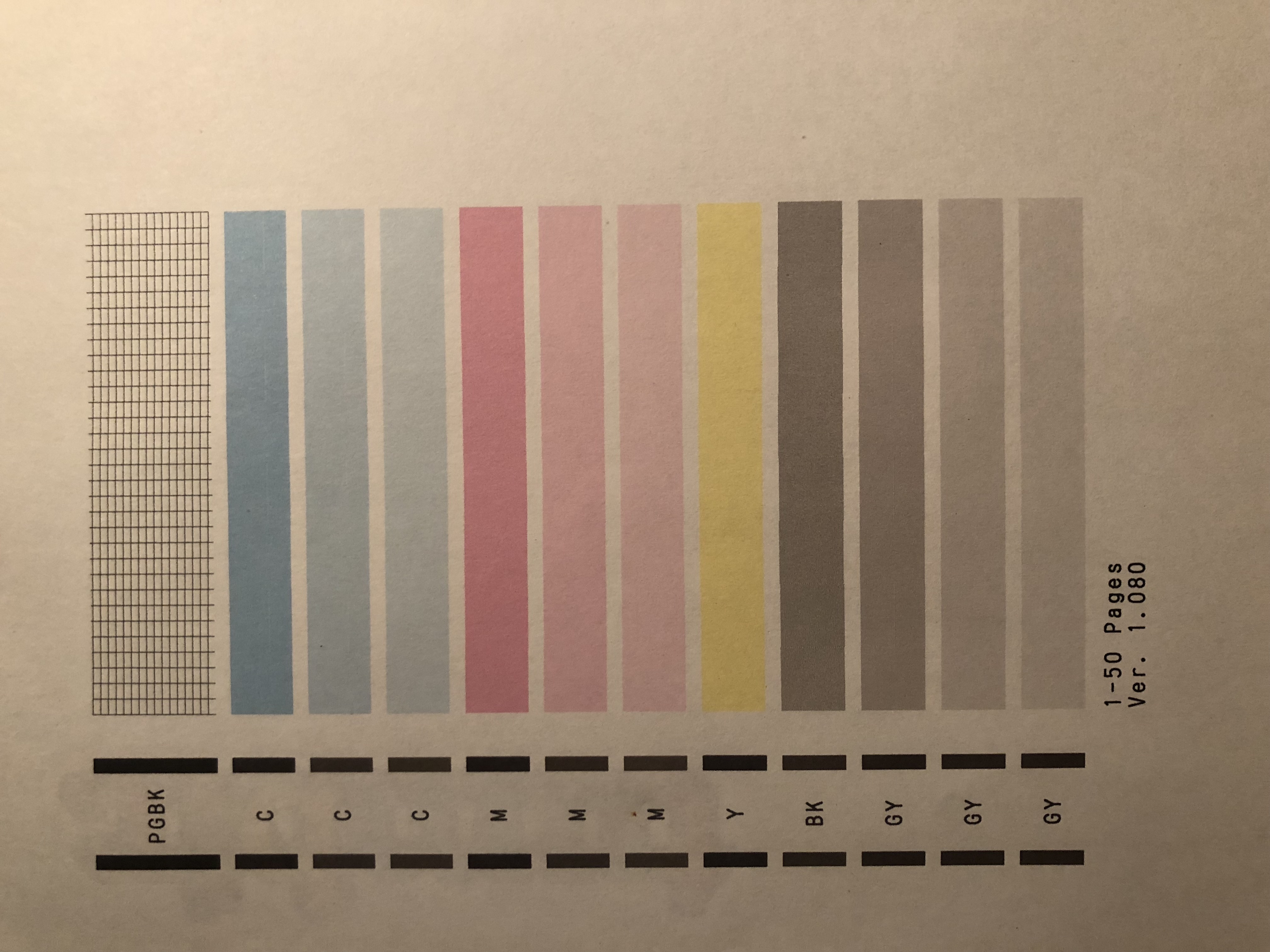

Hello.
A test of your PIXMA iP8720 should be performed. The Nozzle Check pattern shows if each print head nozzle is operating properly. Please perform the following steps to print a Nozzle Check pattern:
1. Turn the printer on and make sure paper is loaded into the sheet feeder.
2. On your printer, press and hold the RESUME button until the printer light blinks twice. When you release the button, the Nozzle Check pattern will be printed.
After the Nozzle Check pattern is printed, take a picture or scan of the print. Then include it as an attachment to your forum response.

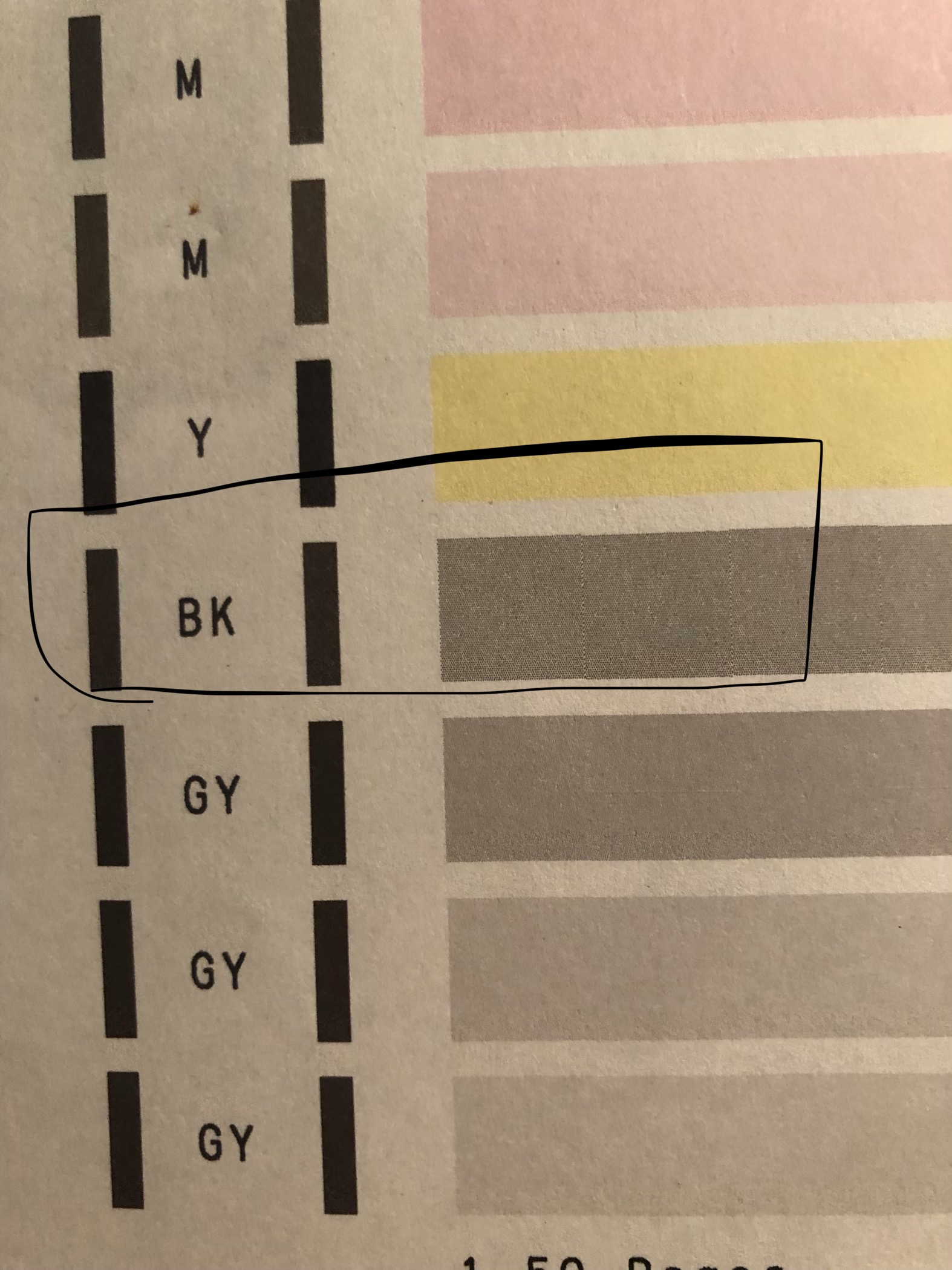

08-29-2018 09:01 PM
Hi Michael,
I did as told and have attached the images.
It looks like everything is okay except for a EVERY SO SLIGHT misalignment on BK.
What can I do from here?

SamanthaW
Hi dolphinwinter,
Thanks for that image. I agree that that small variation probably isn't causing the banding. Many print quality issue can be resolved by cleaning the encoder (timing) strip, and I have included full instructions for doing so HERE.
This didn't answer your question or issue? Please call or email us at one of the methods on the Contact Us page for further assistance.
