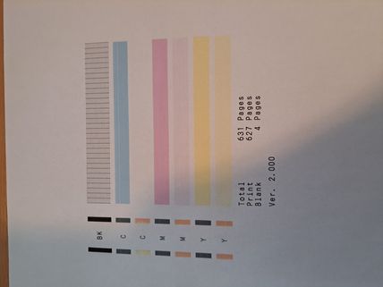

Please load plain paper into the cassette of your PIXMA TS5120 and then please follow these steps:
1. Press the HOME button on the front of your PIXMA TS5120.
2. Use the arrow keys to select the gear icon at the bottom of the printer's display and then press OK.
3. Select Maintenance and press OK.
4. Select Print nozzle check pattern and press OK.
5. Select Yes and press OK.
Please take a picture of the test page that just printed and then attach that image to your reply of this post.

@Mcg80 wrote:
You are missing one of your cyan channels. I also don't think the vertical bars are supposed to be colored.
Examining the Nozzle Check Pattern - TS5120
Have you run any deep cleanings?

I ran a deep cleaning the resulting print out looks much the same as above.
12-31-2024 11:33 AM
Looks like a print head or printer problem. Give Canon support a call. 1-800-OK-CANON.
