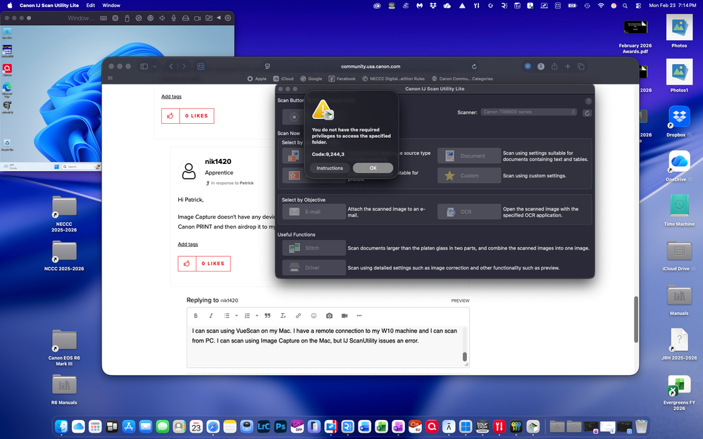

I have MacBook Air M2 Tahoe macOS 26.3.
I can scan using VueScan on my Mac. I have a remote connection to my W10 machine and I can scan from PC. I can scan using Image Capture on the Mac, but IJ ScanUtility issues an error.
