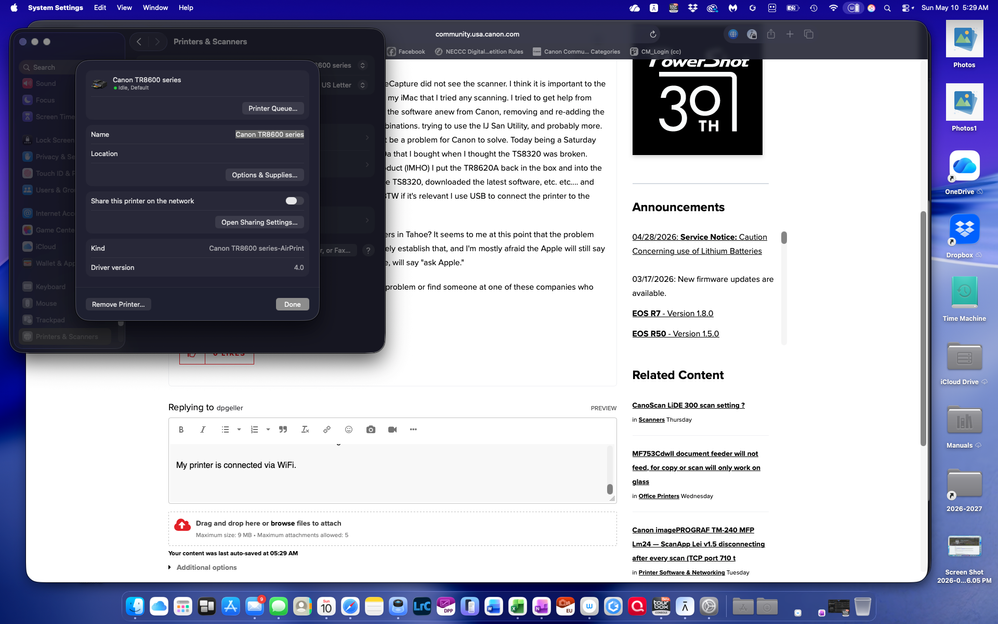

I use a TR8620a with a MacBook Air running macOS Tahoe 26.4.1 and it works fine.
My printer is connected via WiFi.
Screen Shot 2026-05-10 at 05.27.41 AM.pngScreen Shot 2026-05-10 at 05.27.41 AM.png

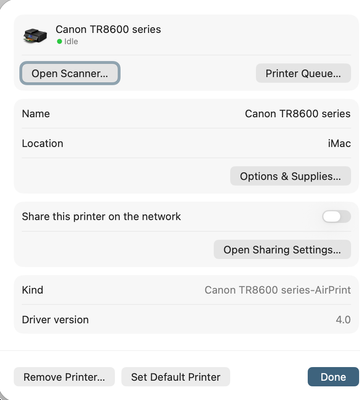

Do you see this information when you go into Printers & Scanners?
Screen Shot 2026-05-10 at 05.29.59 AM.pngScreen Shot 2026-05-10 at 05.29.59 AM.png

I see ALMOST the same thing.THe main difference is that there is a link to "Open Scanner..."; when I click it it brings up Image Capture, which shows 0 Scanners
The difference may be because you are USB connected and I am WiFi.

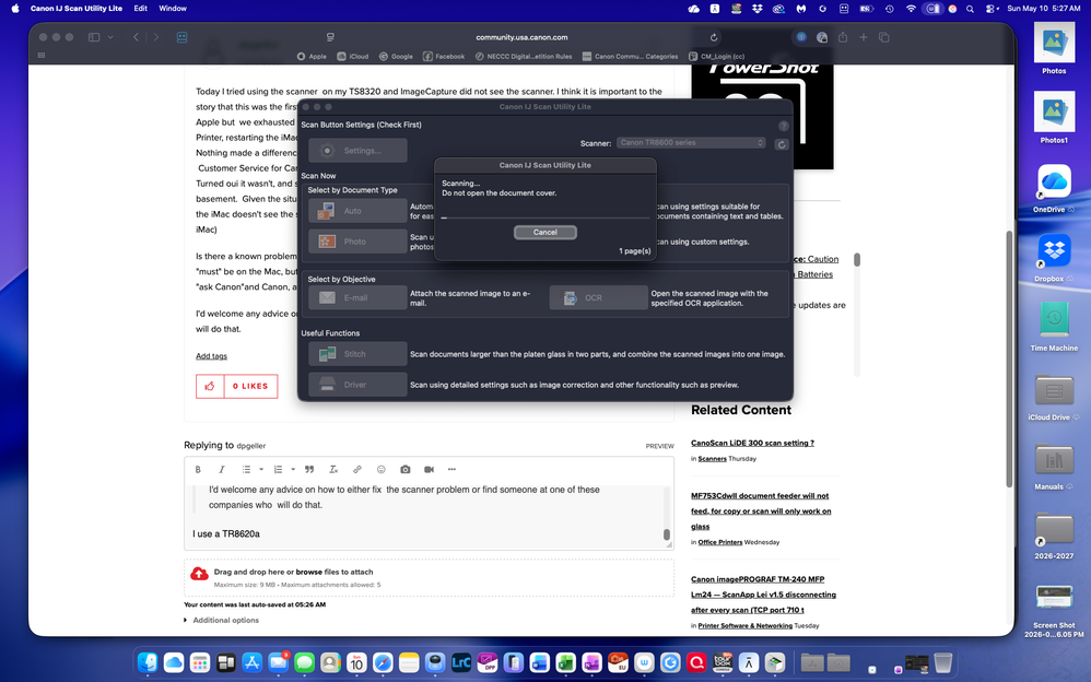

Try using IJ Scan Utility Lite. Should be in a folder in the Canon folder. Or Spotlight search.
John Hoffman
Conway, NH
I have tried the IJ SCan Utility Lite numerous times, with both printers.
IJ Scan Utility Lite with TR8620a works for me. The only difference in setup between your system and mine is the connection. I am WiFi and you are USB.  You could try WiFi and see if that works. If not you could give Canon support a call at 1-800-OK-CANON.
