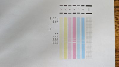

11-18-2022 12:42 PM
hope this helps!
11-18-2022 12:57 PM
11-18-2022 01:05 PM
Hi,
Thanks for adding the pictures. Based on the nozzle check, the ink is not flowing correctly.
You can try another deep cleaning of the printer ink but if that does not resolve the issue, the printer would require service.

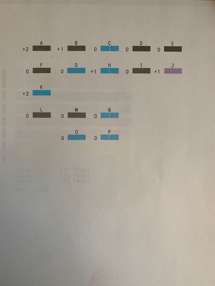

12-03-2022 03:34 PM
Arthur,
I am having the same type of issue with my TR4520. One day early this year my wive was printing and got an alert (doesn't remember what it was exactly) and it hasn't printed well since. Ive gone thru every "cleaning" option in the Maintenance menu to no avail. My info prints are attached. Should I send it in for replacement?
