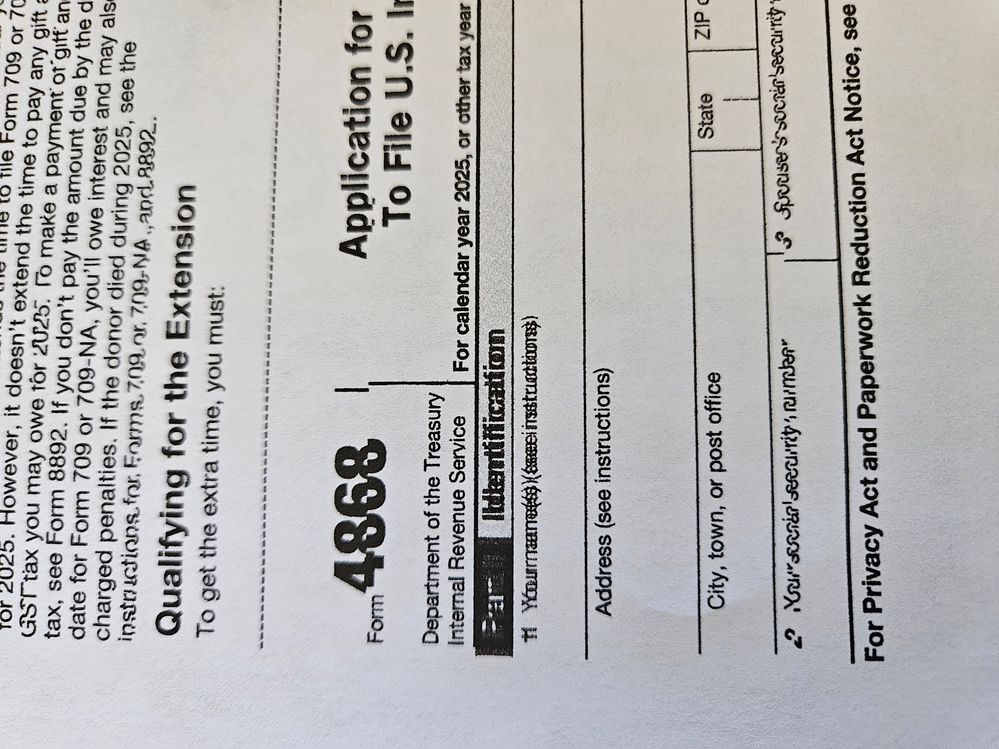

My TR4520 has a weird alignment problem where it prints part of a page normally, then offsets to the right making text unreadable. I did all the usual things without success. Any ideas? 20260408_105359 (1).jpg20260408_105359 (1).jpg

This may be an encoder strip problem which looks a lot like a misaligned print head.

altosoarus
Cleaning the encoder strip and running a head alignment solved the problem and we have our printer back...thanks so much Derrick!
