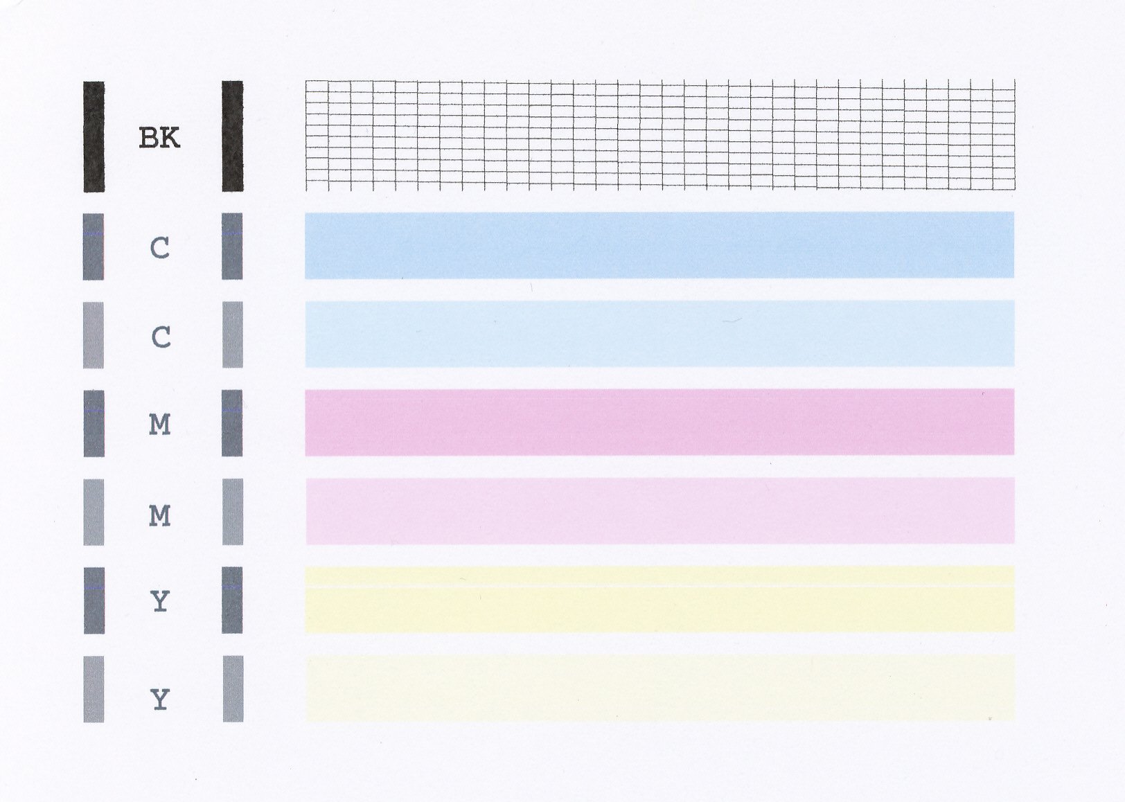

Let's make sure that your PIXMA MX472 is printing correctly. Please follow these steps:
1. Load letter-sized, plain paper in the rear Tray.
2. Press the SETUP button.
3. Press the left or right button until [MAINTENANCE] is displayed in the LCD, and then press OK.
4. Press the left or right button until [Nozzle check] is displayed in the LCD, and then press OK. The nozzle check pattern is printed. Please compare your printout to the example that has been attached below.
Does your printout match the example I've provided?

Sorry for the delay in responding to your reply.
Yes, the printout perfectly matches the example you provided. What is my next option?
