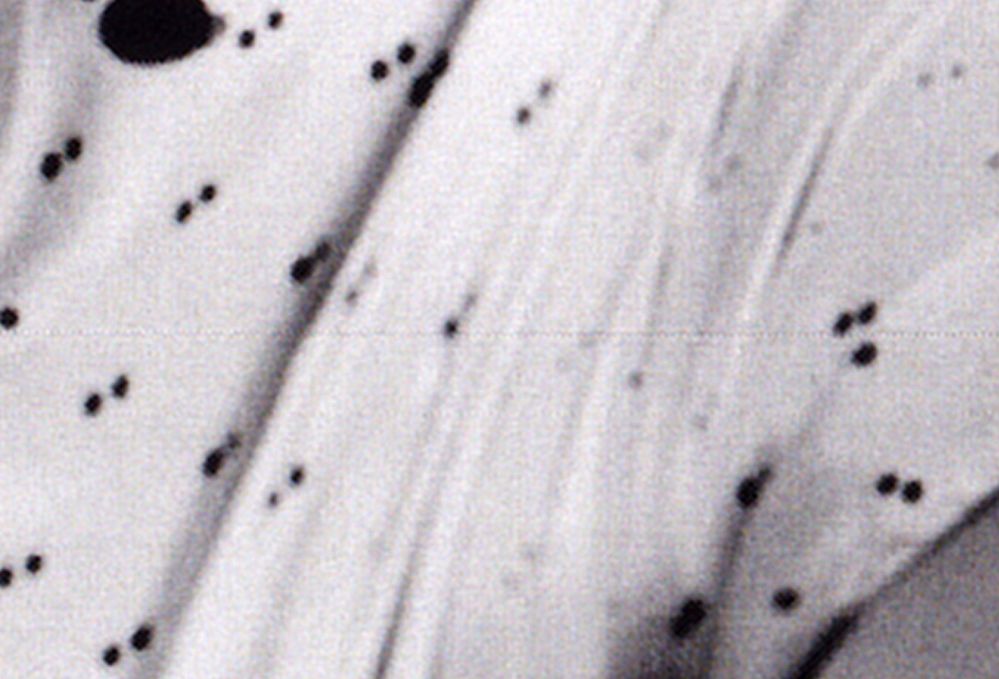

This has been going on for quite a while, but I thought it was down to the printed matter I was scanning.
There appears to be tiny lines running across whatever I scan, whether it's at 150. 300 or 600 dpi.
Someone suggested it's a hardware problem - I hope not, as this is the second one I bought, and would hate to think it's the last.
If I turn Miss Ekberg 90°, the line runs up her nose, so it's not the printed matter.
Any ideas to what could be causing this?

Same effect after following the above:

02-10-2022 02:33 PM
No change after 5 scans:

Hi canonuser3,
It would appear that your PIXMA MX922 would require service. If your PIXMA MX922 was purchased less than a year ago, please contact one of Canon's Technical Support Representatives via phone or chat to obtain your in warranty options. To contact a Technical Support Representative, please use the link below:
