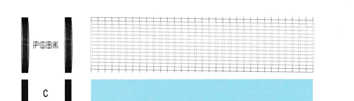

Since a couple of weeks my MG7750 prints double characters for text. I did all the cleaning and alignment steps, but nothing helped.
any ideas?

Hi
I checken cleaned the timing strip. I have the impression there are some markings/scratches/unclarities in this one.On the other hand, only 1 color seems to be affected PGBK. I also tried othe cartridges: same issue
Strange to see only PGBK is affected. is there a way to order a replacement for this strip? I see it's connected with a hook on the right side and a spring on the left side. I could probably do the replacement myself.
