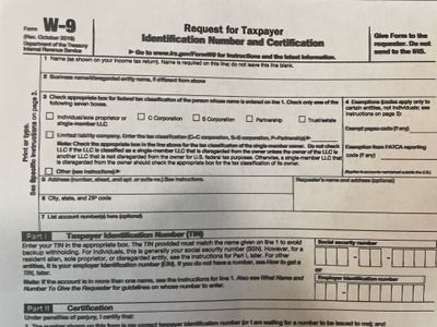

The characters are blurred. When viewed with a magnifier there are double characters offset slightly.
I have tried alligning the print heads with no success. There is reference to aligning the heads manually but I could not figure out how to do this. And don't even know it this is the problem.
What could be causing this?
I can provide a copy of a document if needed.
Thanks chuck

Yeah I have gone through the the head alignment thoroughly. It did no good. the problem still exists.
is there a way to attach a sample of the problem?

I found an instruction on cleaning the Encoder Film. I have done this several times today and as far as I can tell it is clean.
When I print the "nozzle check pattern" the PGBK header shows double letters and the vertical grid pattern lines seperate into double lines in the middle of the grid
Chuck

I recommend cleaning the encoder strip one more time. The strip can look clean sometimes but there may be some remaining ink on it that will cause the double print.
If that does not resolve the issue the printer would need to be replaced. If the printer is still in it's 1 year warranty from purchase date and you have a copy of the paper or online receipt, please contact our support group at 1-800-OK-CANON (1-800-652-2666), Monday - Friday, 8:00 AM - 8:00 PM EST.
